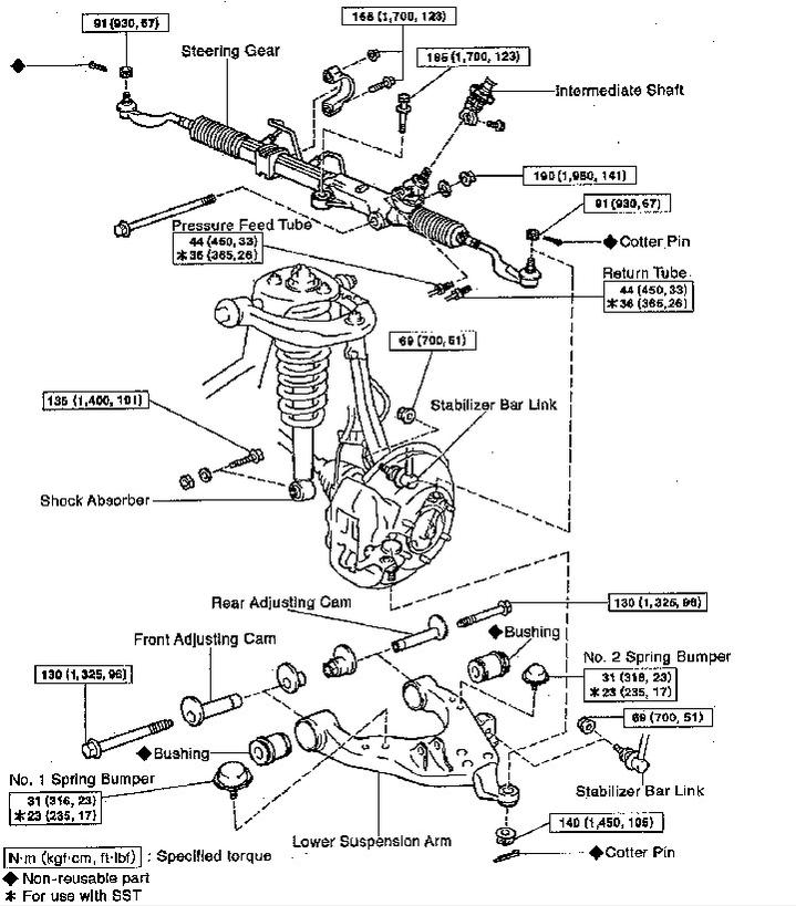

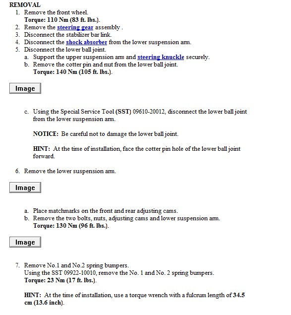

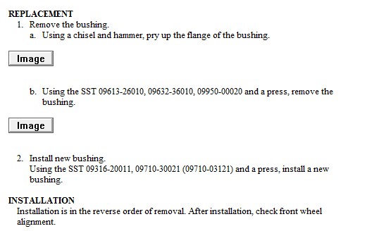

here you go my man

^^He was talking about the rear LCAs. But that's still a nice diagram, I'm gonna save it for the future. :)
