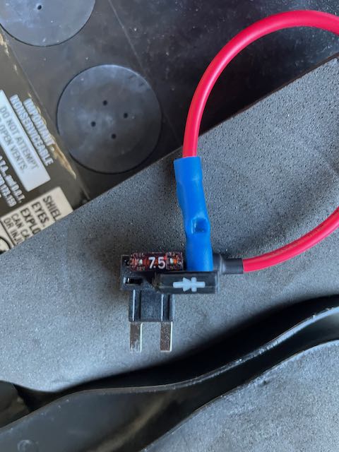

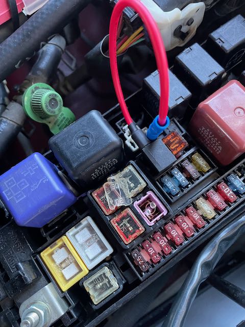

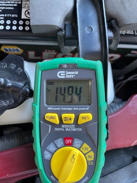

Yeah, I installed one, but the cold idle voltage was close to 15 volts so I took it out.
Cold idle without the diode was around 14.5, so I am going to check the "hot" charging voltage and see if it is below 14.8 which is the max charging voltage recommended by East Penn for their AGM batteries.
I may also try to figure out which diode will give me a 0.3 volt boost.
I also may just say screw it since the charging voltage seems to be in spec of 13.8 - 14.8 volts... and screwing with things that ain't broke usually causes problems.
The diode is GM P/N 12135037.
Charging voltage of 13.8-14.8 ain't bad...maybe you some kind of magic alternator/voltage regulator! As you will recall from earlier in this thread, I installed the HKB variable diode, and set it at +.6V in the spring of 2022. I left it at the +.6V position all winter, including several weeks of work in Lax Vegas where it was routinely ≈32ºF in the mornings. The voltage on the Scangauge never went above 14.9V at cold start, and always quickly came down to "normal" levels as the engine warmed up. I have found in the subsequent year that the battery stays more fully charged even after a week of around town short trip driving. Right now, I can't drive the 4Runner due to a foot operation, so I got a Renogy solar trickle charger 10W Solar Battery Charger and Maintainer | Renogy Solar which stays hooked up and gets about 5-7 hours of sunlight every day.
Maybe magic! Yes, previous post was noted, appreciate the info, and I always trust but verify. The alt is 27060-62160-84 and I fried the rectifier a few weeks ago, then replaced it with an aftermarket rectifier. Running 2 awg wires. Nothing too radical.
