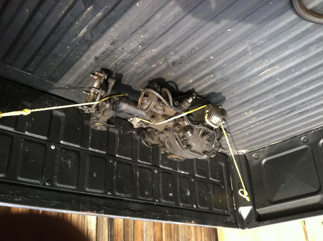

I did this a couple years ago and it wasn't that hard. I bought a 4.88. geared 8" third member off CL for $220. I found a '93 factory 4.88 ifs front(G144 code)in a pick-a-part for $120. Add in the Spartan locker I bought on Amazon for $375. I swapped my long side axle for the '93s ADD axle using a Timken axle seal(p/n:710419) I sold my original 4.10 8" back to the guy I bought the 4.88 diff off of for a $100. So all told I did a gear change and a rear locker for around ~$600
