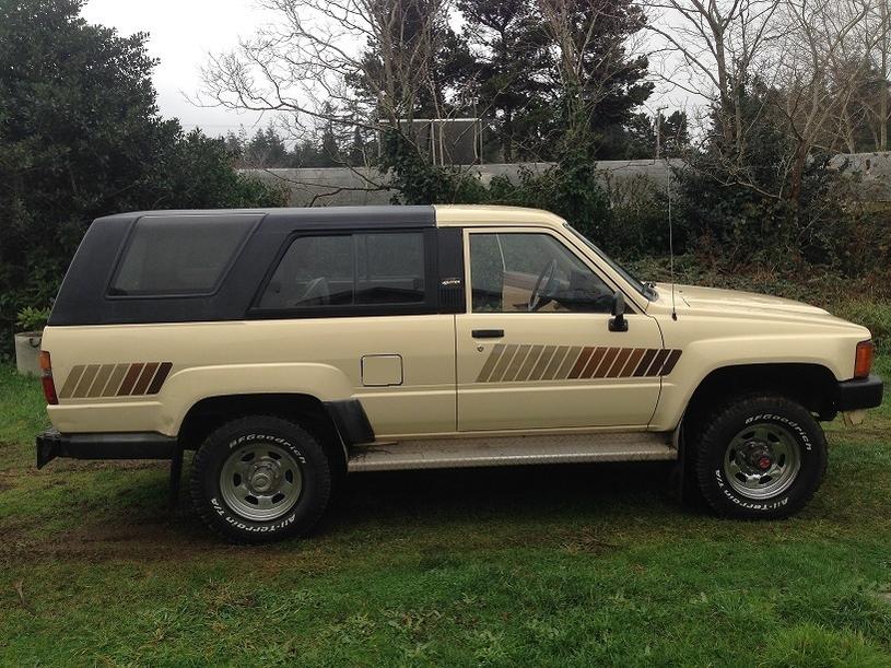

The Firestone Destination T/A's are lighter and cheaper. I have them in 31x 10.5 on my '89. It's supposed to be the largest 15" that will fit without a lift. I agree the stock size will look tiny. I wish I'd remembered to tell the guy to mount the white lettering inside.

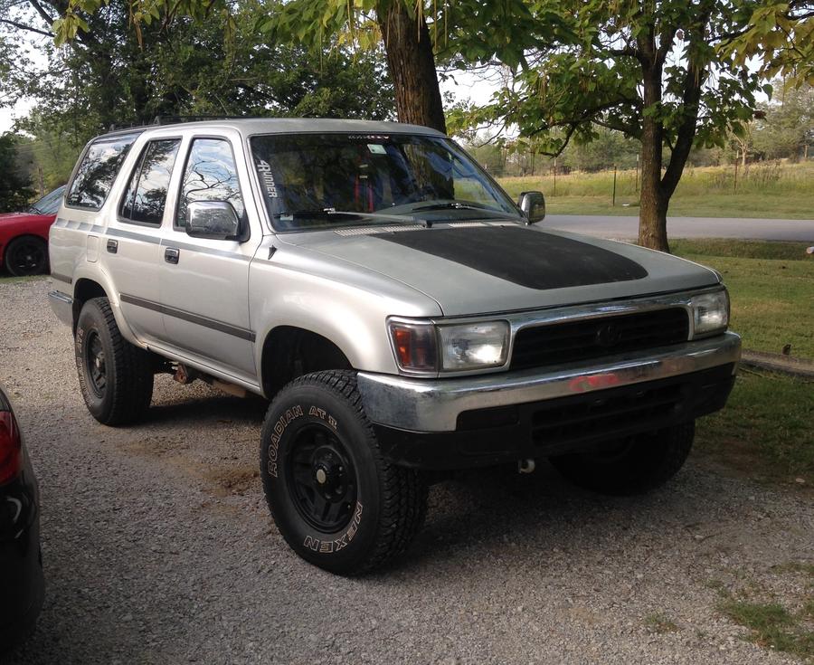

Here's 31x10.50's on my '92 on stock wheels and stock suspension, no lift or anything. Just removed trim and running boards. At 70mph I'm right around 2800rpm, getting 14mpg, but don't think the horrible gas mileage is due to tires. These are Nexen Roadian AT II's (came on it when I bought it), also keep in mind that different tires will vary on actual diameter and width. I know these are actually 30.5" tall for example, and the BFG TA KO's are 31.7". Not much of a difference but just an example

Here's 31x10.50's on my '92 on stock wheels and stock suspension, no lift or anything. Just removed trim and running boards...
Looks good! Are 31's stock on that generation? I actually wish I got 31's instead of the 235's but the 235's don't look that bad.
I also like mine without the chrome trims (no running board either), but would like rock sliders someday.
