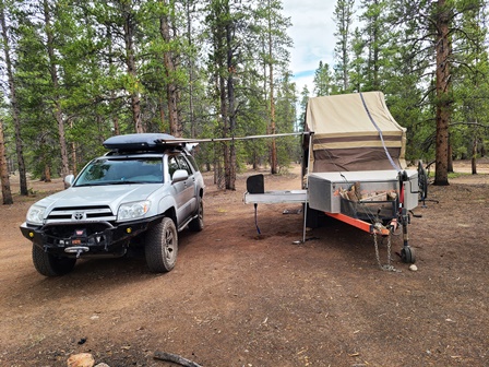

Is anyone running 255 75/17 size tires on OEM rims?
alia176
Senior Member
I'm curious to hear the overall impression of this size tire. I've been running Falken Wildpeak AT3 265 70/17s on OEM rims since the beginning and was thinking of running a tiny bit narrower and tiny bit taller. I have a 2.5" lift all around and slightly rub with the current set of tires on full lock. I'm on the second set of Wilkpeak AT3s and looks like AT4s are out now. Just weighing my options.
Also lmk the brand of tires you're running and pics will help!
Have a great weekend y'all.
