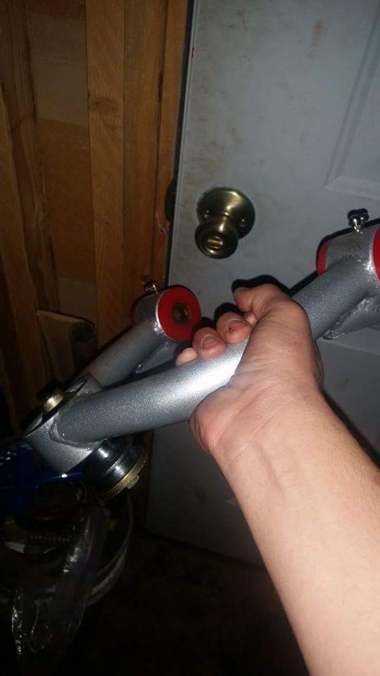

I have a chance to run these control arms off of ebay for $150 brand new. I've heard they're okay with some small changes. Obviously they're no $600 or $1000 ones but the few people that ive seen have them said theyre good if you change small stuff. With the money saved i think its worth it. Anyone got them? Show pics

Seriously though, there are some reviews around. The sleeves on the poly bushings are too short and will cause the poly to wear. I'd be cautious about weld quality.

I run them, and after going through he kinks I love them. Word is they have updated some of the issues...i.e. they went to a similar set up as Icon concerning how they bolt up to the knuckle.
