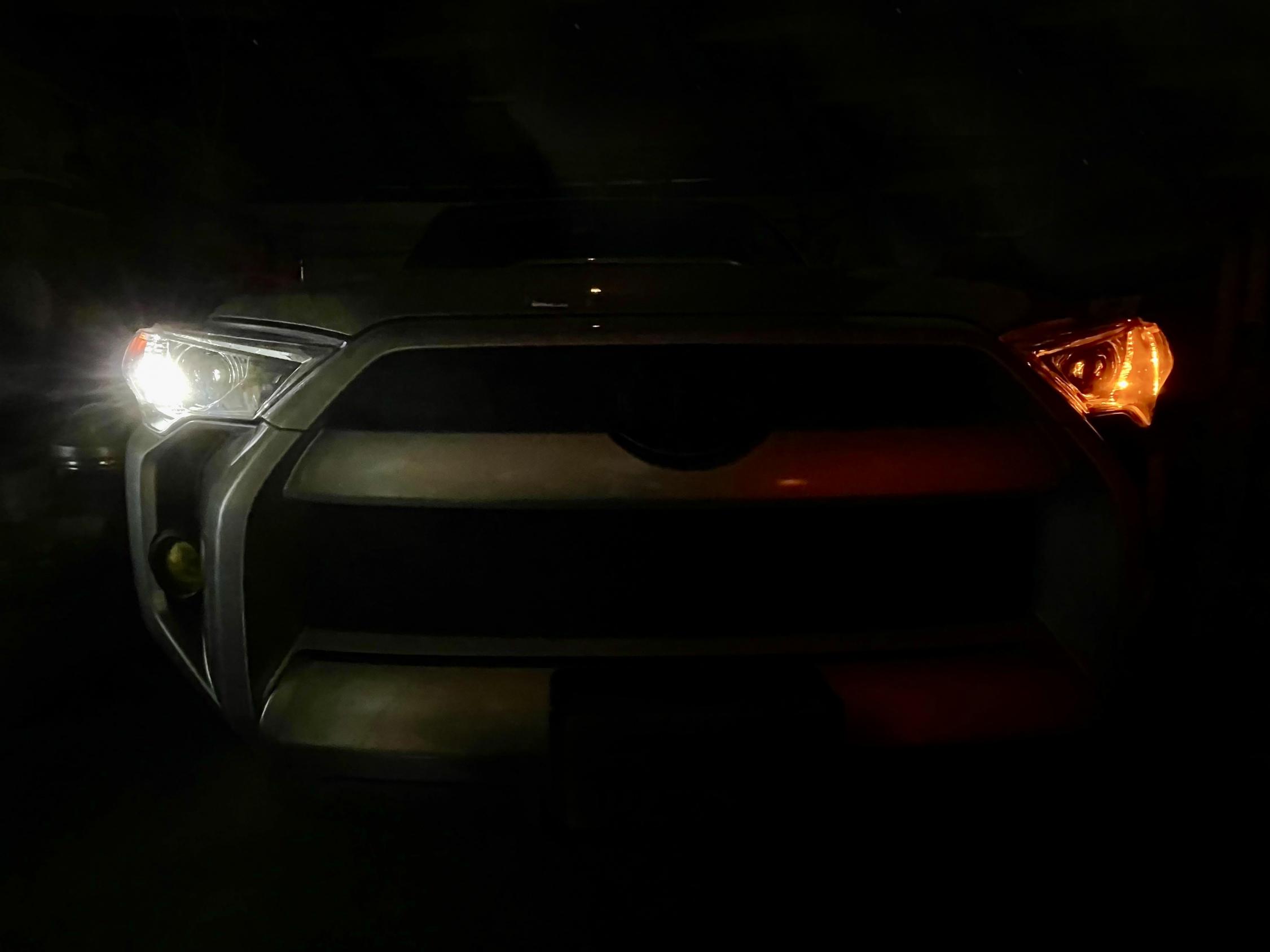

Curious how the front switchback looks like at night against a wall? Would hate to drive around with parking lights blinding everyone.
Here’s a head-on shot with parking lights on. New white switchback vs old Lasfit amber.
Parking lights are not as bright as low beams.
(Plus, in many states you’re not supposed to drive with parking lights on). :yo:
