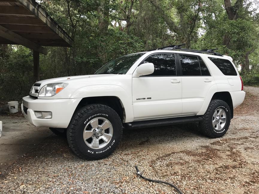

Here you go... installed yesterday with 5100's set at 2.5. Very minimal rubbing.
What are your overall impressions the last week? Please show us more pictures! :photo:
I sent you a visitor message. Did you get it? Tires have been great. Slight rubbing on UCA at full lock after alignment but I haven't had to trim anything. Will post more pics when I can.

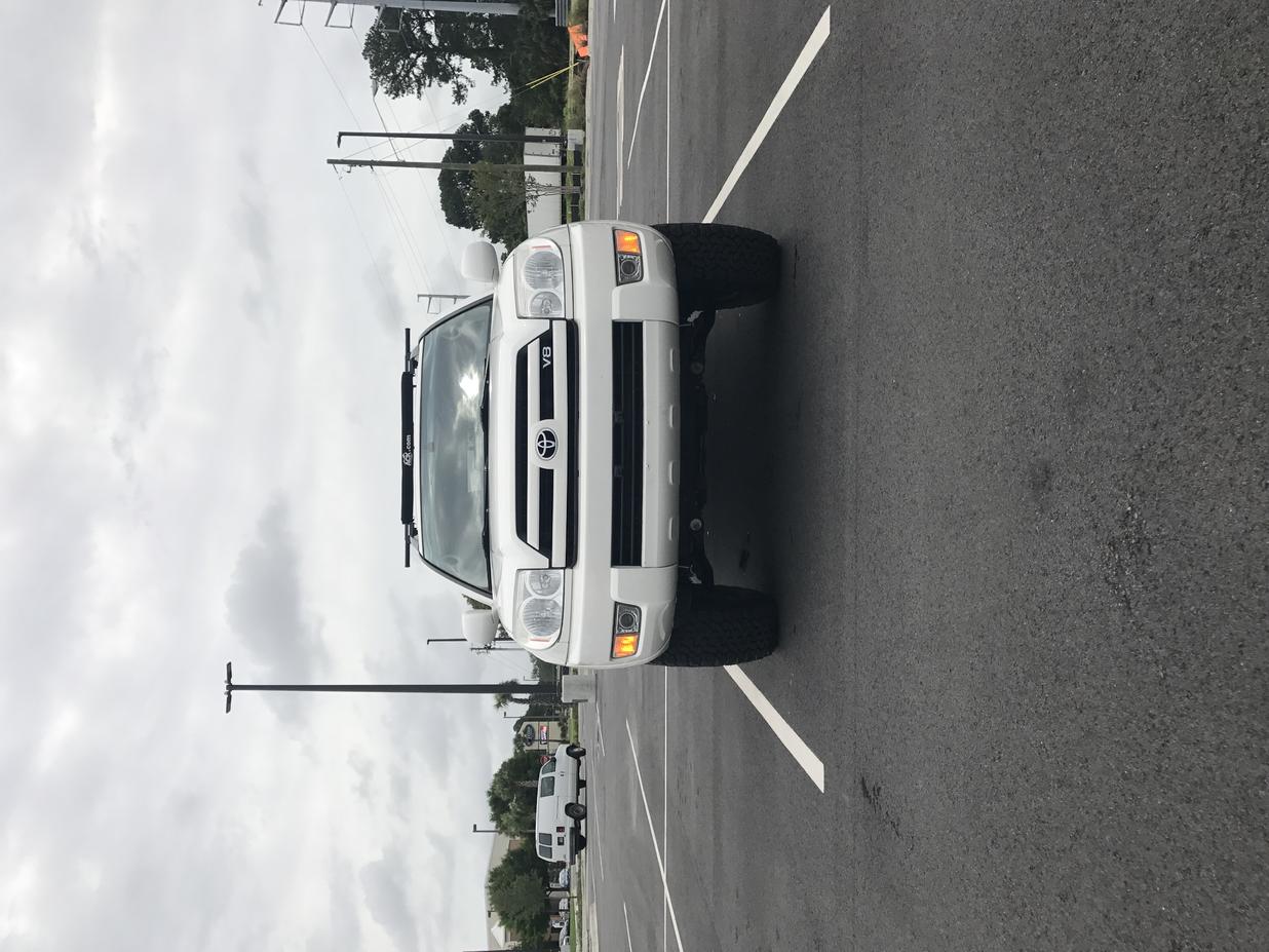

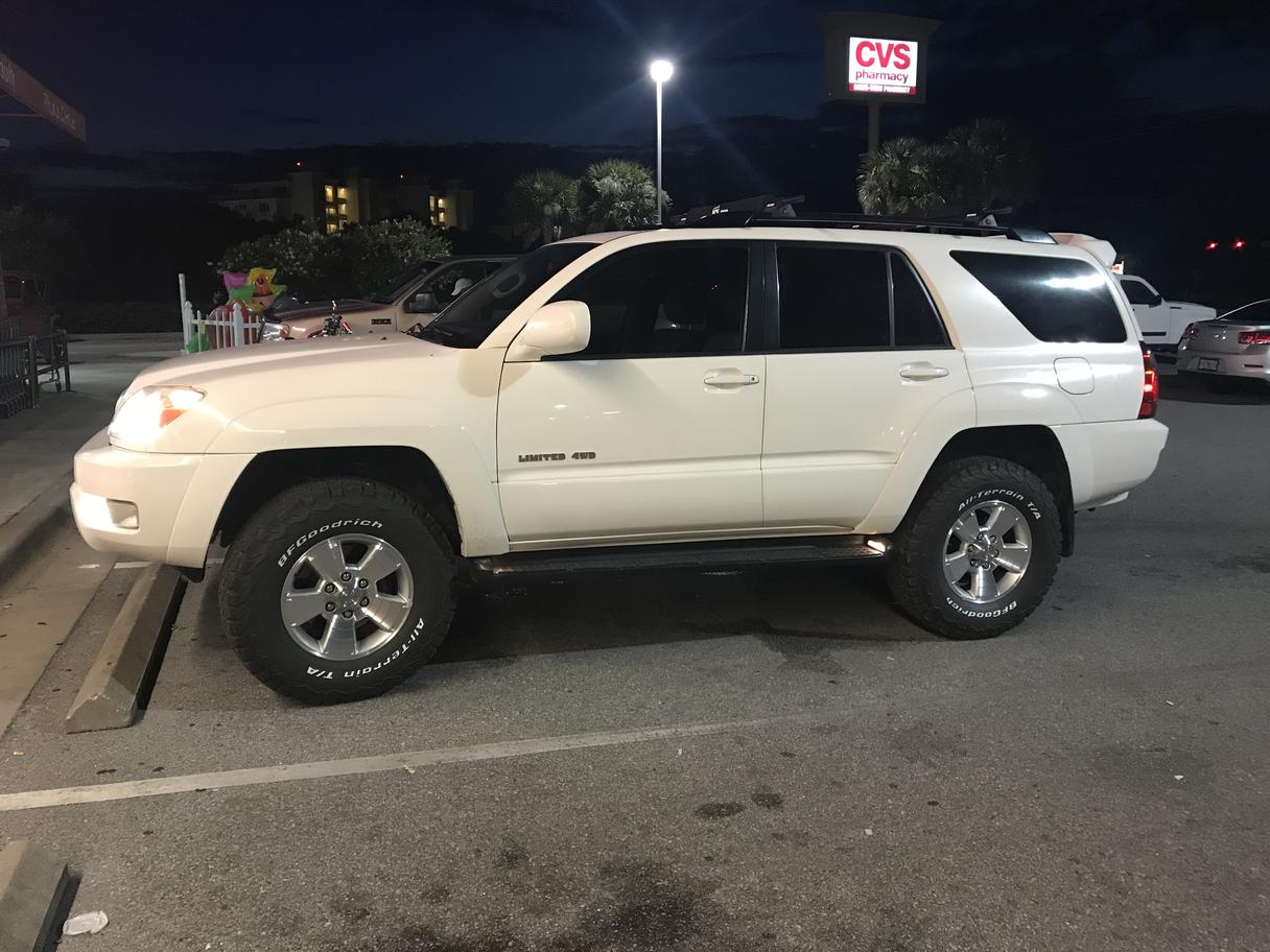

I just installed the same set today. They just barely fit without rubbing. I previously had the castor maxed out so I left the alignment the same as before. Here are some pics. I have at 2.25"-2.5" lift up front. Maybe less. 2" in the rear. I'm thinking about putting my front mud flaps back on after some heat gun massaging.
The picture exposure is blown out so you can see the clearances a little better
So far the effect on acceleration and braking is not at all what I was expecting with the V6. It's not bad at all for my purposes right now. My style of off-roading is more mellow, desert trails and the popular southwest Colorado trails.
