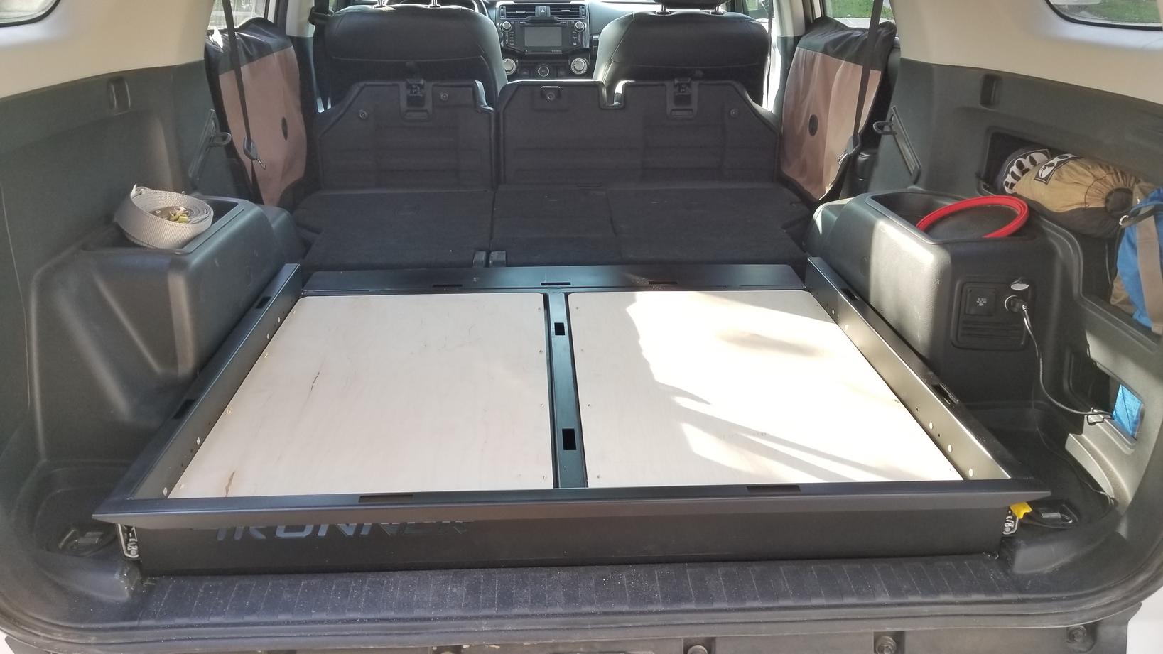

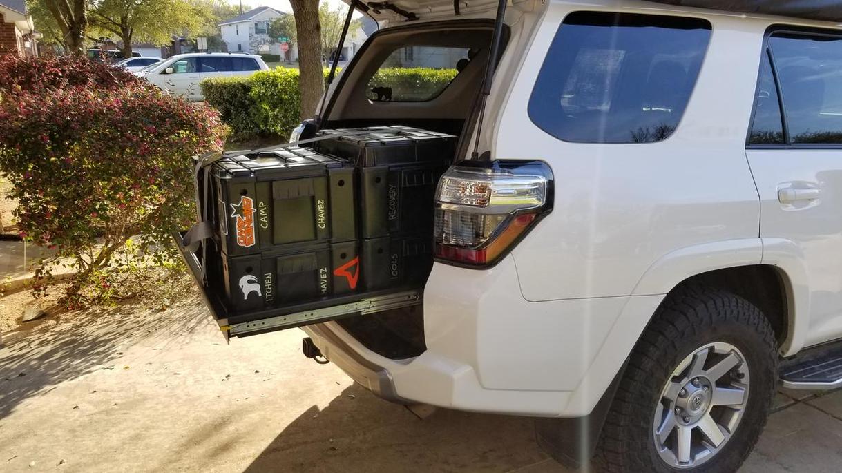

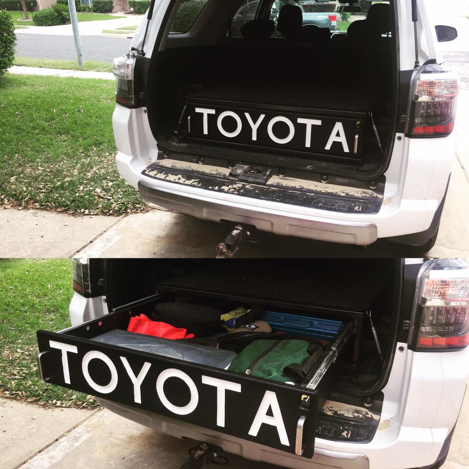

I actually have built and used both each for about a year and the HeavyDuty cargo tray is a WAY better solution than the drawer. Even the single large drawer system that I build (best way to build a drawer IMO). The factory cargo tray and the steel tray that I built dont even compare (Strength, tie downs, perfectly level with folded seats, etc)
The biggest advantage is being able to take everything out and have a fully flat floor, I now pack all of my gear in boxes and I can tailor my load out to the activity. If I am going to a park or somewhere not involving serious off-roading, I can bring just my camp and kitchen gear. Furthermore, for solo trips, I can ditch the RTT for some improved MPGs and move all my gear to one side of the truck and sleep in the back.
Anyways, here are pictures of both.

There is a base frame and a tray, the base frame is flat and has 4 - 1" tabs that go through the carpet and bolt to the body using the three angled M10 holes in the cargo area. The whole system comes out and only leaves 4 small 1" slits in the rear carpet.

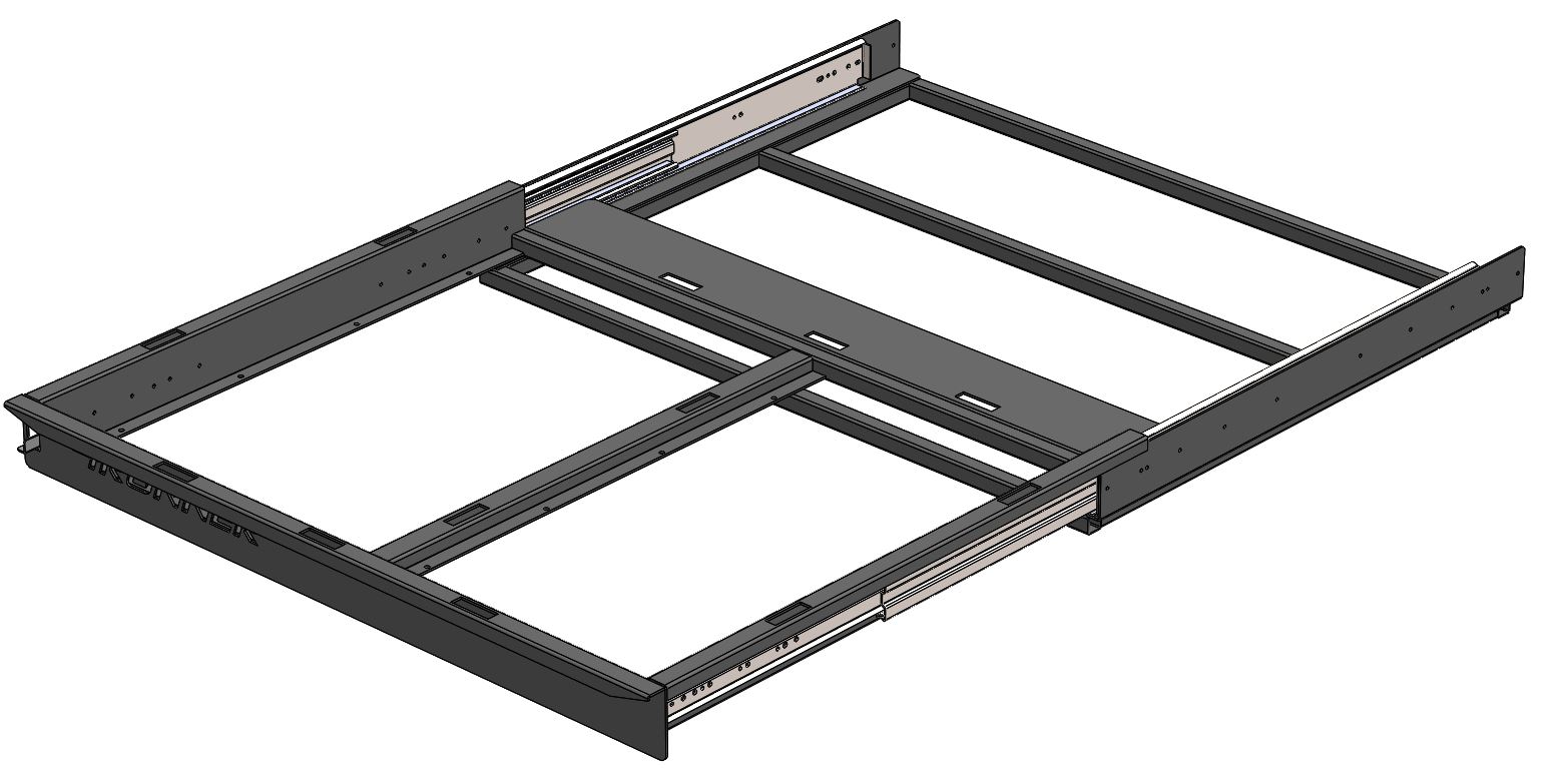

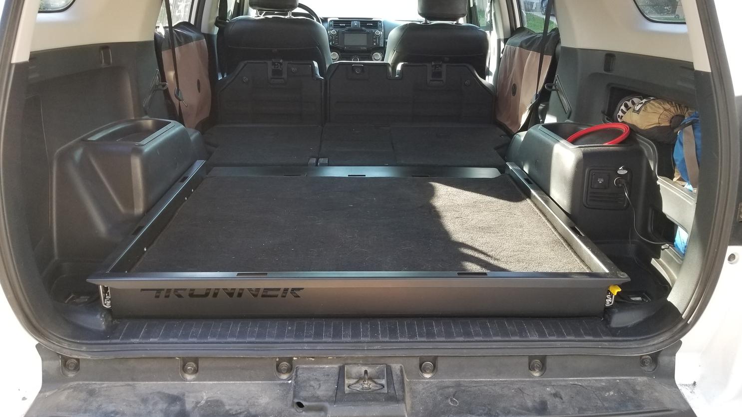

I posted a few more pictures in the drawer/storage system thread. Here is another picture from before the carpet went down and some CAD, so you can see the sub-frame. The sheet metal parts are not quite DIY, they require plasma/laser and a pretty decent sized press-brake. I had the parts fabricated and then I welded it all together.
I imagine you can come up with something similar that can be built completely at home.
