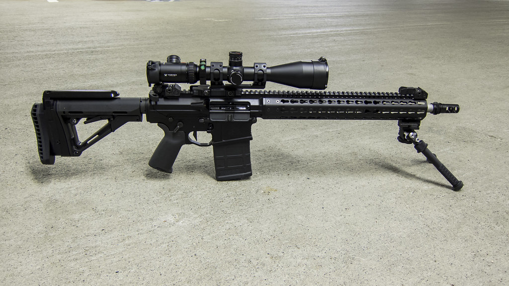

I built a few AR 308's including my own.
DPMS pattern has more options regarding parts vs Armalite pattern.
Keep in mind some lowers will require the same manufacturer's upper. The most important advice I can give you though is if you are going to build, make sure you headspace your bolt to your barrel.
