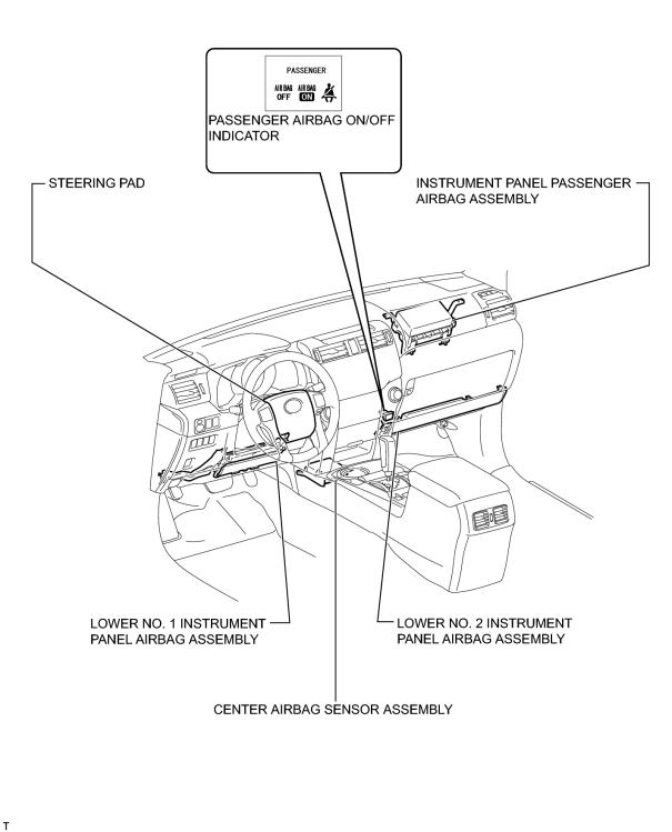

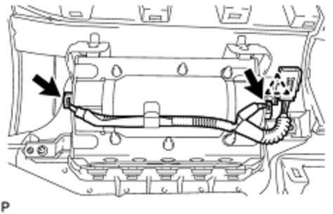

just unplug it. you will have an air bag light on your dash. its a small red light which isnt annoying to see during night driving as would a yellow one (ex check engine light. it will set a trouble code for open circuit on passenger airbag in the airbag ecu but will not cause harm to the system itself. dont do it with the key on at all. repair manual usually tells you to disconnect the negative on the battery when doing so but i never have.
heres a small pic for you

you may not have to disconnect both connectors on the side of airbag but the main connector that they both lead to.
this will require glovebox removal
