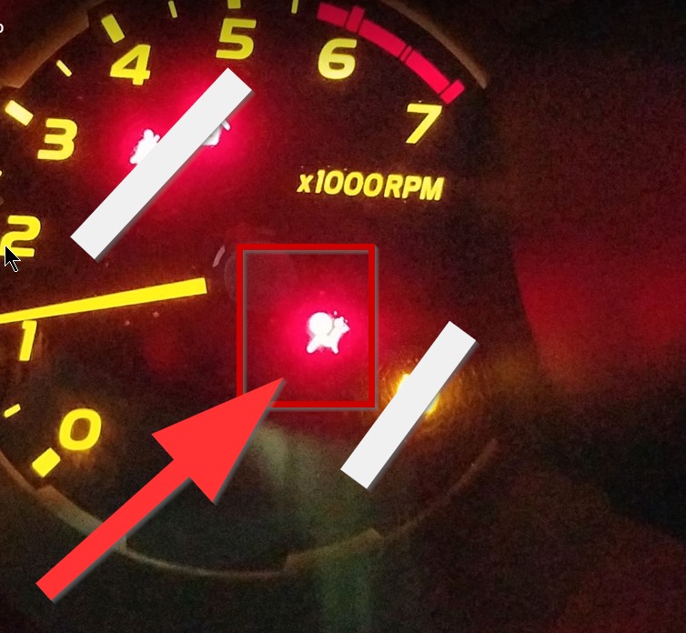

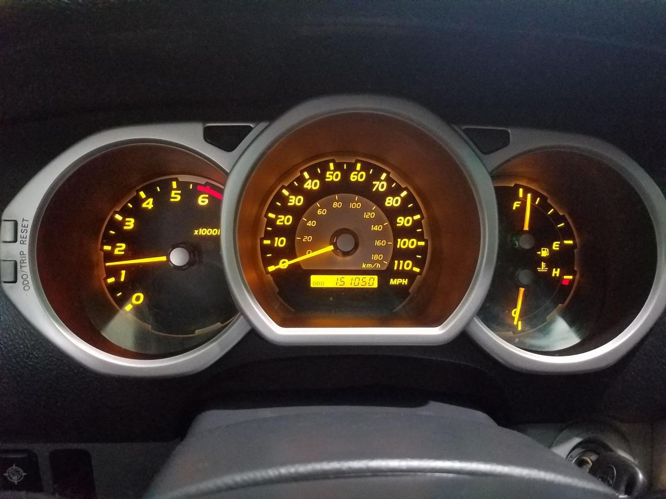

Original Post ***So... anybody ever have this light come on randomly for no reason? Ive had the truck 7 years and never had this issue.
I believe any recalls that were out for the 4runner airbags have been addressed
I checked under seat connections, all looks and felt fine. I don't want a takata airbag to the face.***

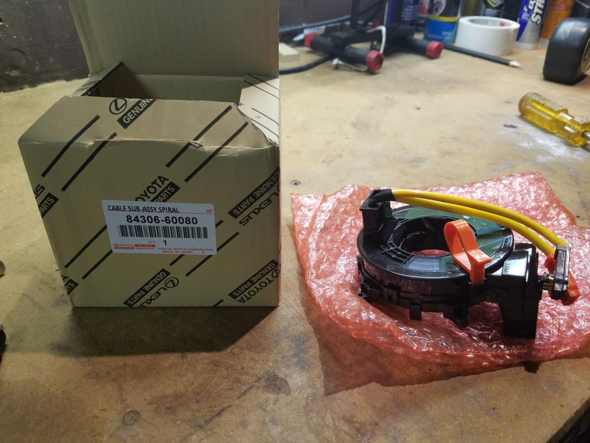

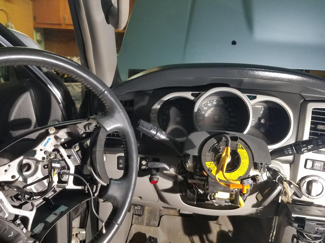

Update*** Had the code scanned which after doing some google searching all signs pointed to Clock spring. I ordered an OEM genuine toyota part off ebay. Part number in picture.
-Also disabled my TPMS light while I was already there.

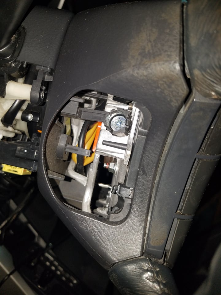

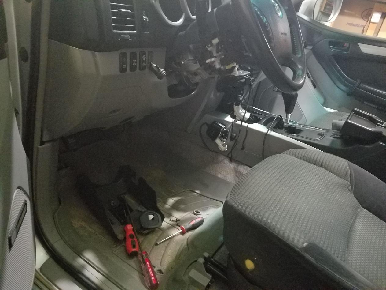

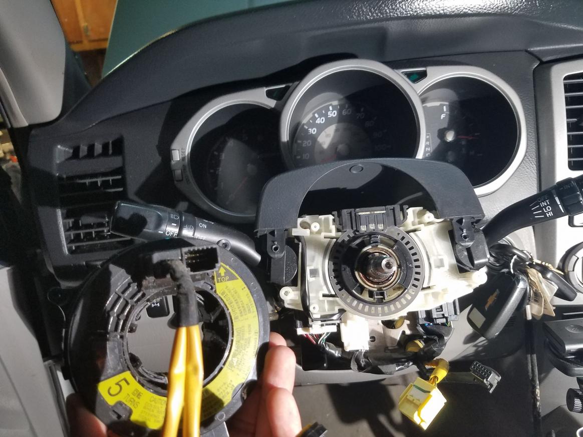

Quick Write up with steps. :
-Disconnect Battery for at least 10 minutes.
-3 Phillips screws around steering column shroud (must turn wheel side to side to get each screw but always return to center)
-remove shroud and small plastic cover plates on each side of wheel
-Remove 2 T25 screws that loosen but dont completely remove
- Pull horn/airbag assembly towards you gently.
-disconnect Horn ground wire, Radio control Plug and the Red and Black airbag power (from the airbag side!) CAREFULLY
-Remove horn/airbag completely
-19mm nut for steering wheel
-Always return wheel to center after loosening nut
-use steering wheel puller( I didnt) or Bang on the wheel a few times and it will come loose, then simply pull towards you.
-Careful of wires!
- remove wheel completely
-Remove 2 plugs on bottom of Clock spring Black one and yellow one. CAREFULLY not to bend the pins!
- Remove 4 small phillips screws holding clock spring
-install new clockspring and make sure wheels are straight and the clockspring is set to center!!!
-retighten 4 phillip screws
-carefully break orange tab off and make sure its still center!
- replug in the 2 plugs to the new clock spring on the bottom.
- reinstall steering wheel snug!
-Becareful of wires!!
-Plug back in radio wire, ground to horn and airbags CAREFULLY
-Snap center horn/airbag into place and retighten T25 screws
-Reinstall Shroud
-DONE!

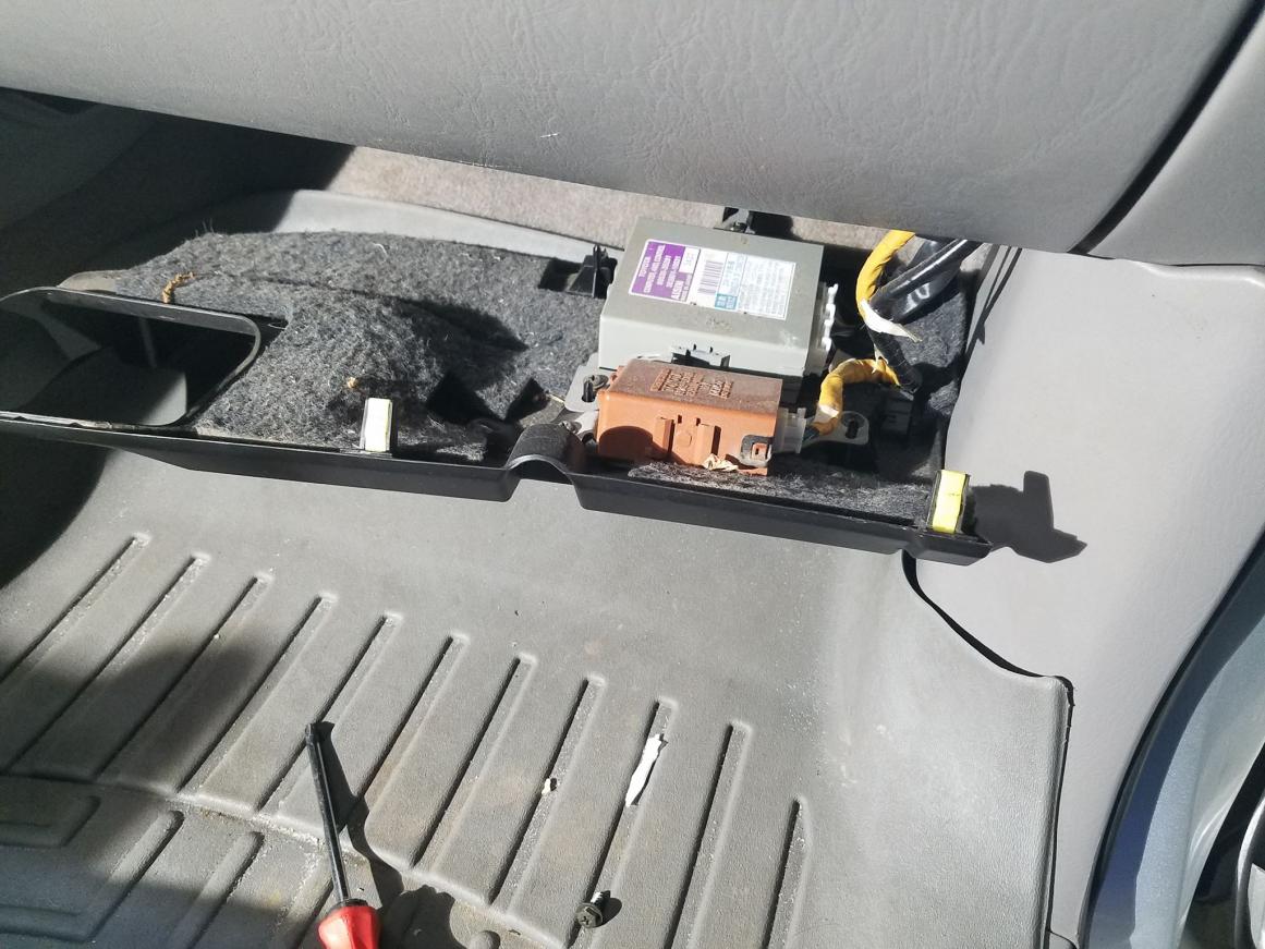

Prob need to get a cheap copy of techstream and read the module for faults for better direction. There's many more points of error than the under seat plugs, what made you go to those? Recently have the seats out?
Nothing really made me go to those other then its easy access, since I was on my way to work when this happened this morning. I have read other threads in the past on other toyota's that the wire harness under the seats and to the belts could get weak or frayed over time causing similar issues.
The light went off when I drove it on lunch and then came back on while driving. so something is weird. Im going to try to get it scanned later. Didnt know if there was a common culprit to look for though.

To my belief I bought an OEM clock spring off Ebay ($40), however I noticed that the OEM one has a yellow tag around it, where as my replacement one has a green tag(see below)? Either way if it becomes a problem, its a simple enough job to replace again and I'll get one from Toyota directly if the need ever arises.

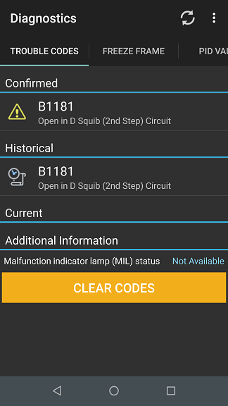

The SRS light illuminated on my 2007 4Runner, and I was able to troubleshoot and fix myself after reading this thread. An additional contribution to this thread...the Android OBD Fusion app (with 2007 4Runner adder) and a elm327 OBD2 scanner was able to communicate with the SRS computer to get the trouble code. This app saved me the cost (and trip) of the dealership reading the trouble code. I called O'Reilly, Auto Zone, and Advance Auto, but the rep that answered at each store stated that their free ODB2 reader could not read SRS trouble codes.
The trouble code was "B1181 Open in D Squib (2nd Step) Circuit" which indicates an open circuit for one of the circuits to the steering wheel airbag.
I ordered a new spiral cable (clock spring) from the online store of a Toyota dealership which is about 30 miles one way from my house; so I had it shipped. I saved about $100 compared to the price of 3 closer Toyota dealerships. Since the spiral cable is part of the airbag circuit, an eBay spiral cable did not seem like a good idea. But who knows...maybe the quality is the same...and the "stealership" has a huge markup.
The new spiral cable is installed, and the SRS light did not return after a 30 minute test drive.
