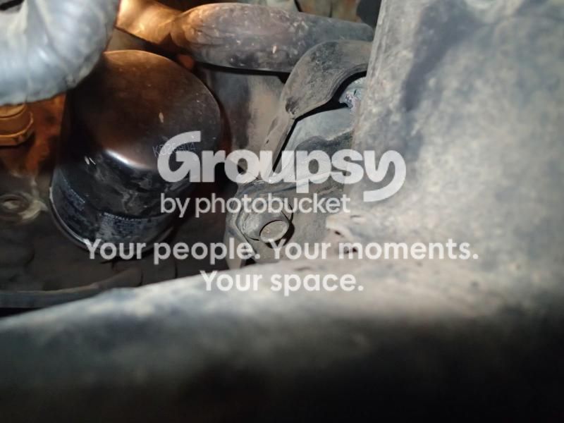

That's not right...I can easily fit my fingers between them....
looking in from the wheel well:
P1187021_zpscf4e7f26.jpg~original
I use V8 filters, so it's taller than usual, but the same otherwise.
Ya, pretty much was certain it shouldn't be like that. I'm perplexed as to what would cause it though. I can only think a wreck, but that's some pretty serious frame deformation? Never had an issue with alignment.
Guess I'll just have to dremel all my oil filters from now on! It totally makes sense that people thought it was stripped because, it would rotate, then tighten up when it rubbed on a 'high spot', then get past that high spot, and loosen back up. So people (myself included) mistook it for stripped threads.
Is the motor mount itself the issue?
Guess you could avoid the dremel-the-filter routine with a remote kit, but were it me I'd still be trying to figure out the issue at hand, ask myself if it's the engine sitting cockeyed or is the oil filter somehow crooked. Oil filter doesn't make sense though, or it wouldn't seal against the block, right?
You'll have to keep us posted.

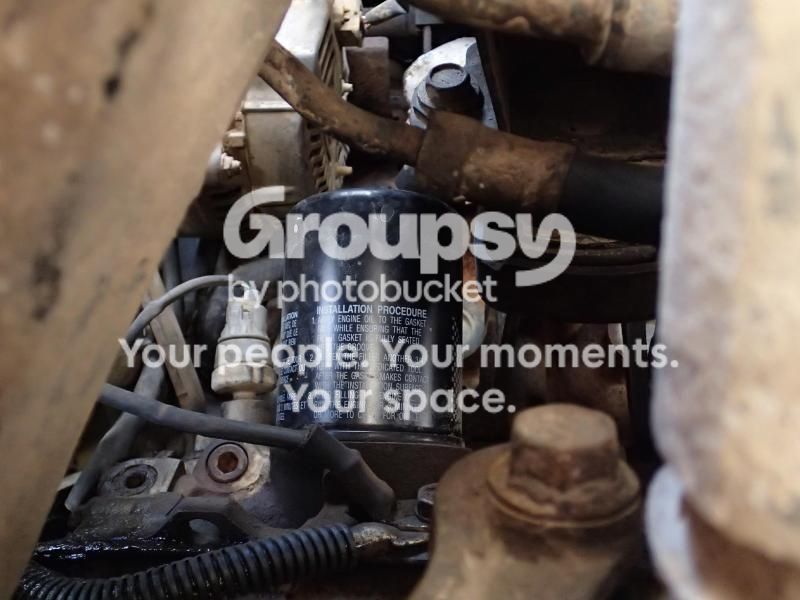

It's not dark and the driveway's not wet anymore so here's another pic that matches yours more. Keep in mind my filter's about an inch or so longer than stock.
