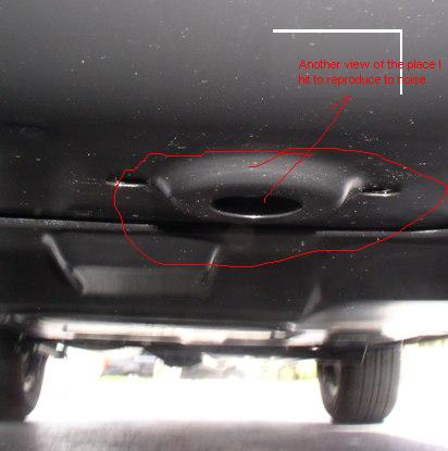

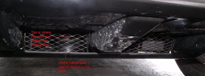

Anyone else had this clunk from their skidplate area.
Mr. Lambdebois
All bolts are tight but when I hit this area you can clearly hear contact. I hear it when going over decent bumps... and is driving me crazy.

Take the skid plate off and see if you still hear the clunk. There are four bolts that hold it on and when they are off the plate will hang by the two flanges in the front. There is nothing wrong with driving without the skid plate on unless you plan on driving over unimproved roads where the center of the vehicle may bottom out.
The only thing I could think of is the plate is not snugged tightly. There is a large circular metal support in the center rear of the plate that rests on a frame cross support (terminology may be wrong so don't go slap bad crazy on me). If it is not snugged down that might be contacting the frame cross member intermitently and driving you crazy.
Try driving with the skid plate off for a while and get back with us here in the forum.

That is what is contacts the the frame cross member. However all bolts are GNT.
I will run out and take it off in a little bit and let you know....
Just by the off chance. Can you or anyone run out and hit the area in the skid plate I posted in the pics? see if you can get any noise out of theirs even though you don't hear it when you drive.

There is no TSB for the noise you are having, but I do believe you have found the offending problem. You have four choices:
1. Go to the dealership and, if you can convince the service writer to crawl under the vehicle with you, reproduce it for them and have them fix the damn thing, don't forget to say, "damn thing!"
2. Take it off and glue a thin but durable o-ring with a similar diameter to the metal that touches the frame crossmember. Reinstall it and see if that makes an appreciable difference.
3. Take it off and put it in the garage. This solves two problems. One is the clunk noise. The other is that you won't have to remove it to do an oil change, if you do that kind of thing.
4. See option #3 and place it into a brown box for shipping and sell it to me. I bent mine all to hell on the Big Bend trip and refuse to pay the stealership price for a new one. :yesyes:
Good luck.
Mr. Lambdebois,
From your other thread regarding the tire rub, I believe this issue is related to the recent oil change. The last person who changed the oil bent the skidplate when removing the filter or possibly let it hang by a few bolts to gain access thus causing the plate to distort and not mount flush. You may need to experiment a little to get the noise to stop, but I'd bring it in to the dealer first.
Yes the last person did not unbolt the oil pan at all apparently. When I asked them how they got to the oil filter they showed me and it was clear their arm slightly bent down the side of the skid plate and made it rub. After checking the bolts I just gave it a slight bend back. No more rub....
I still don't think that bending the far side of the skid on the outside of the bolts where it was hitting the tire on right turns, would cause a distortion in the very middle of the skid if it was bolted down tight when the oil was changed. The other thing is I had noticed this noise before the oil change.
