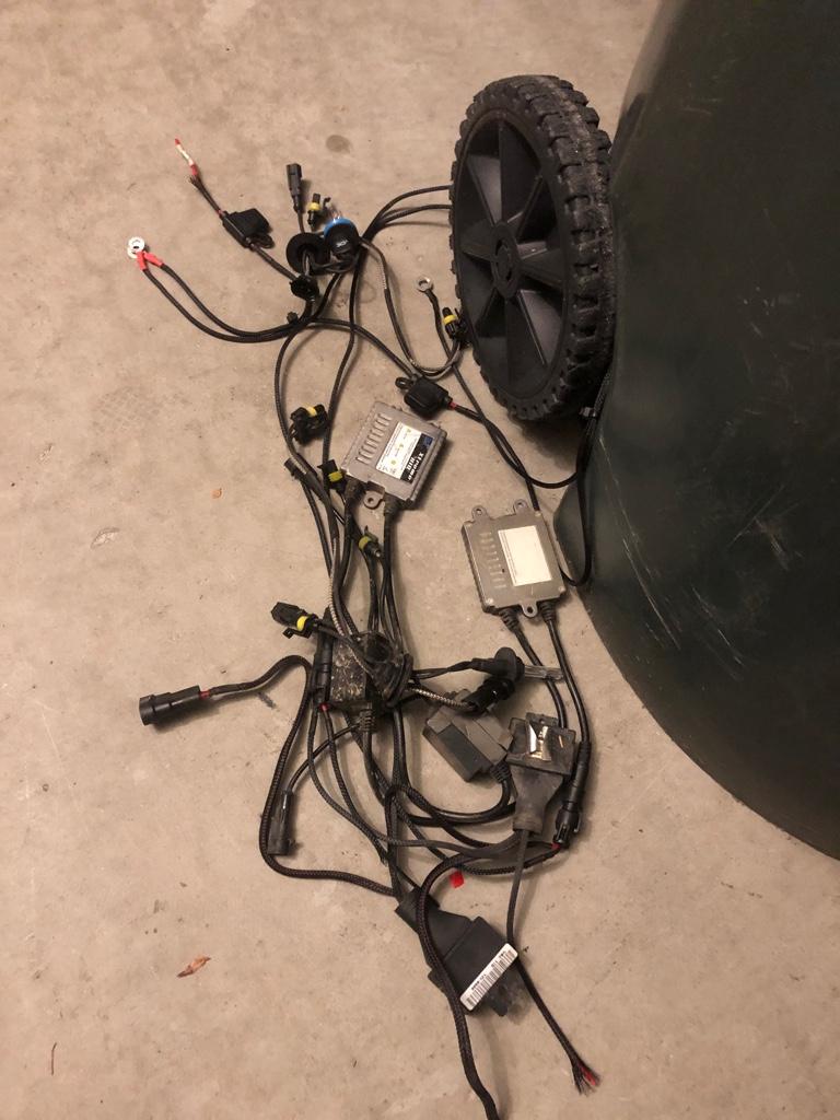

Funny to read this. That’s a pic of my xenon depot that I just ripped out of my runner a couple weeks ago.
I was so sick of one side not firing up or turning on.
I was constantly f’ing with them.
Sure they light up the road like nothing else but the juice was just not worth the squeeze.
I installed morimoto 2.0’s tonight.
They aren’t as bright as the xenon depot but there is zero wiring and I won’t have to jack around with anything.
( and they are still so much brighter than stock )
