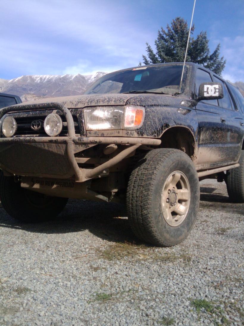

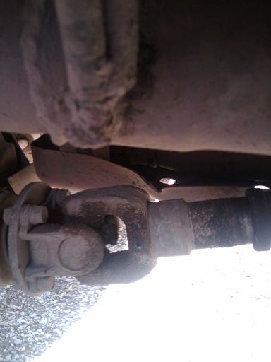

i broke off a zurk on my yoke thingy on my rear driveline last night, was flexing on some mad rocks up the canyon, and my zurk caught my gastank skid plate and kinda tore the skid plate out a little and broke my zurk off! i wasnt to happy haha but all in all was worth it :)

Yeah, mine's gone too. Tires are eating at the rear of the wheel well ( rear tires), and the weight on the driveshaft is eating a hole in my tank. You gotta pay to play I guess.
Only when I flex like this. Well used to anyways it has "self clearanced now"

that's very common. i have sonoran steel 1.2 on mine. included in the kit, there's a hex screw to replace the grease zerk. when the drive shaft is due for lube, just put the zerk back on, couple pumps of grease gun then switch back.

Dew, once you swap out to longer shocks it will hit even further in the tank because the swing of the arc will allow more contact. Take a 2x2 or 2x4 and a nice sized hammer and gently "massage" the contact area so that it is a little further away. It doesn'e need to be caved in or a lot just enough that the skid is just about against the tank.
thanks for the tip, i was planning on dropping the driveshaft out and doing some skidplate "adjusting" like you said, and trying to get that grease fitting to come out :)
