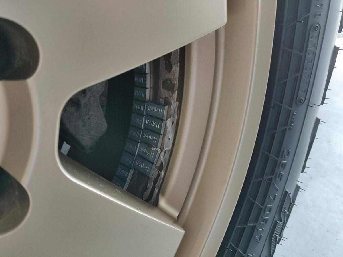

Additionally look at this. This is not how brand new wheels and tires should look like.
Looks like some pretty sloppy work right there. At least your wheels and tires looks great!
