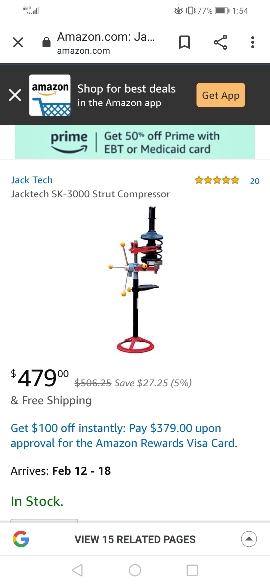

I've used the cheaper one that [MENTION=140253]Drew76[/MENTION] mentioned, found it on amazon for around $100-130 bucks but it the teeth bent while compressing-it was a little sketch. I now own a Branick 7600 that I found on craigslist for around the same price. It is much safer to use. I've helped others with their 4runners, Tundras and FJ's so I definitely got my moneys worth. I will say it takes up a lot of space though. I would love to find an OTC strut tamer and give it a try but the Branick is found in every shop that does struts/shocks. It's an industry standard.
Really? I've used mine dozens of times on all sorts of vehicles, the only problem I had was the original long travel jack stopped working after like 10 years (new similar jack was more $ than the whole tool), I replaced it with a normal bottle jack that is from the 80's/90's and probably better quality than the new ones and some heavy wall square tubing as spacers to make up the difference in height, used it last to compress some Bilstein 6112 front coilovers no problems
Thanks for the feedback and recommendations, I'm kinda leaning toward the Jack Tech style now. Will let you all know how it works out

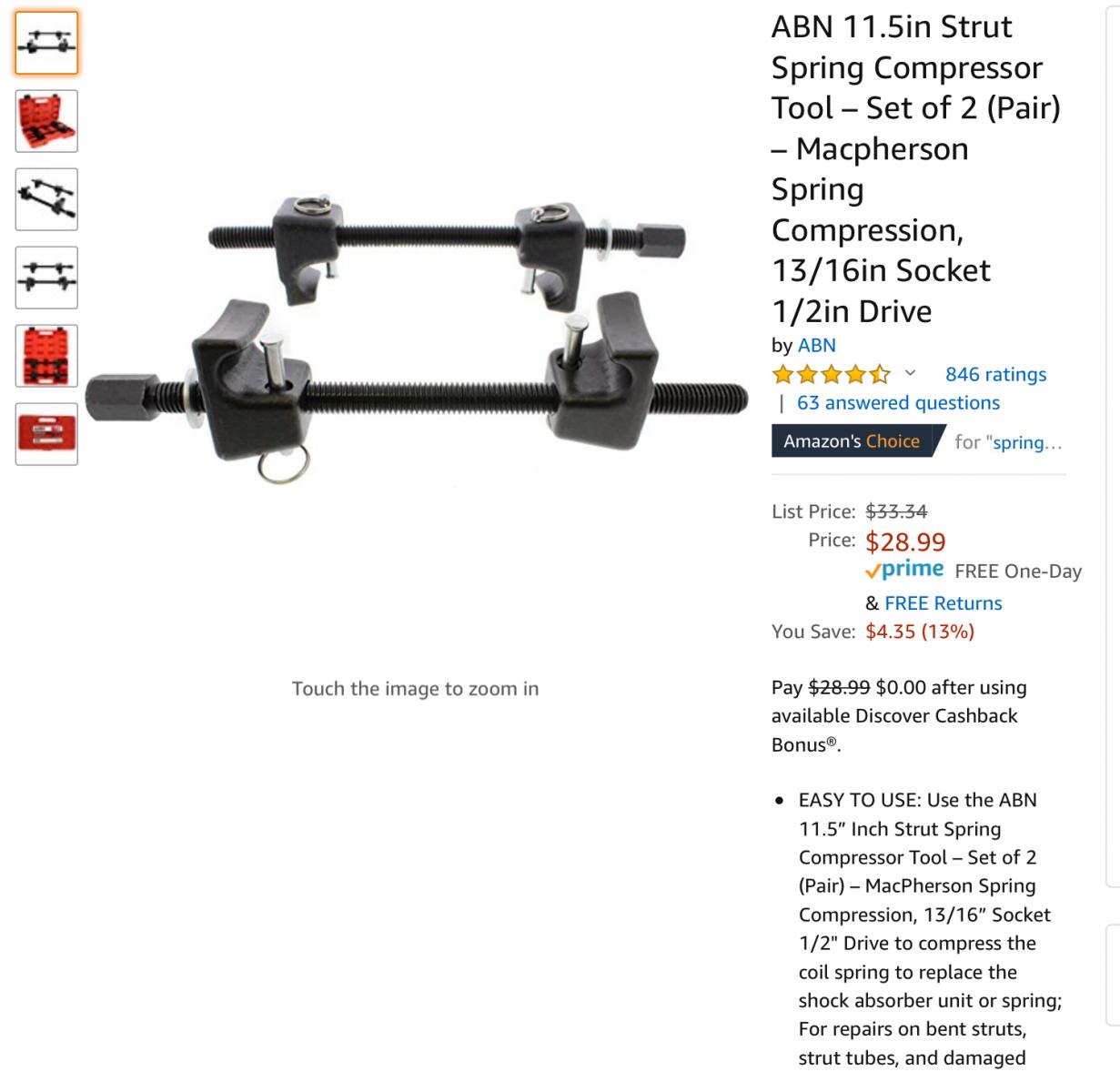

Picked this one up on Amazon for under $30.
Worked great when it came time to install new front struts/springs. Even used it to help install new springs in the rear as well.
Those are the absolutely frightening to use POS things that they are trying to Avoid. Plus, you could have just gotten that to use, for free, from any autoparts store anywhere and not spent a dime.
Helps to read the first thread to know what info might be helpful to post.
There was actually nothing frightening at all about using this spring compressor, worked like a charm with no drama at all.
I was just offering up my own personal experience with a tool that was recommended by another forum member (Timmy The Toolman).
BTW after reading the ENTIRE thread titled “Anyone have recommendations on a good spring compressor for struts” I thought maybe this could be an option for the OP or someone else who comes across this thread and wants a safe low cost option.
Besides my endorsement and the others on this forum that have used it are the 800+ positive reviews on Amazon that gave it a 4 1/2 star rating.
Not all of us live near an auto parts store that offers free tools and some of us also like to have our own tools so we know they’re well taken care of and in good operating condition.
So yeah, great low cost spring compressor.
