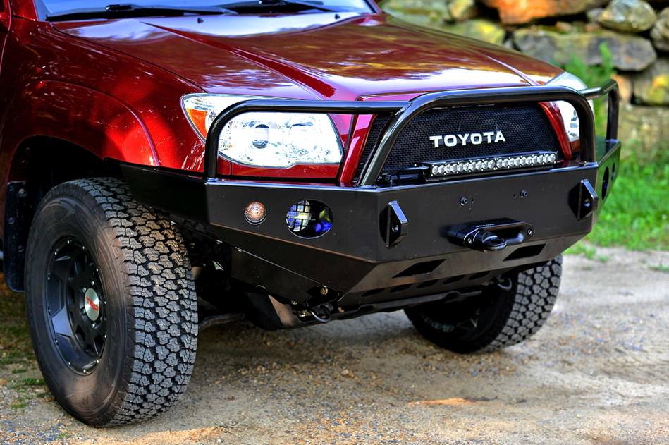

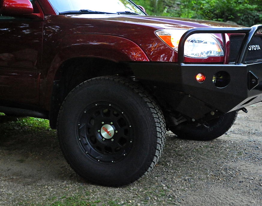

I have them as we'll in black. (I left the faux bead lock rings off on mine)
I really like them; very tough wheels.

jdkilroy - I REALLY like them in black. Where did you find them?
My truck is stock, no lift yet. Would I need a spacer to run them or are they fine as is?

I found them as a closeout from a shop in one of the Carolina's I think (I'll look for the associated email and edit this post if I still have it) Get the part number and search that way to find them; they aren't very common; originally for Taco or FJ.
Offset is ~ 3/4" greater than stock so they also widen your stance a bit without getting spacers.
They are actually smaller than my stock wheels; I dropped down to 16's so I could increase my sidewall height for better off road performance. I went from 265/65/17 --> 265/75/16. Had a little rubbing before the new suspension but that was only wheel well liner and easily remedied with some minor trimming.
Edit: Part number: PTR18-35090
Not the best pics but give you idea:

Hate to bring this thread back from the dead but everywhere I look it says these wheels won't fit on a 2008 t4r sr5 but then you guys are both using them. I was just wondering if you were running any type of spacer with the rim. I have a Daystar 2.5/1.5 lift that I am going to install as well so I guess the question is if you think these rims wrapped in 265/70/16 tires would fit with that lift and an otherwise stock setup. Thanks in advance.
I think the only problem you'd run into is if you had the larger calipers a-la-sport edition. Then 16's just don't fit period.
I'm sure someone else can chime in and correct me if I'm wrong, but if you have 16's now I think these fit just fine.
i would think the only reason they would not fit was due to the caliper size on your truck. 16" FJ TRD wheels fit my 05 SR5. I think i read they would not have fit if i had the larger sport or limited calipers.
