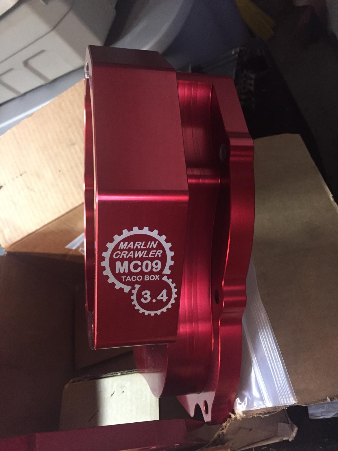

Just got my dual cases plate and planning on running dual cases with IFS front end. What are you guys running dual cases with what crossmember?
I am :becky: Currently I am just running the stock crossmember since it is ahead of the dual cases. BUT I am adding a second crossmember off of the reduction box. Now I am a 5 speed so my trans is a little shorter than the Auto guys and the cases fit a little better in front of the gas tank. Also [MENTION=32837]J-money$$$[/MENTION] is running dual Cases as well.
Yup.
I have the Front Range Offroad Tacoma crossmember on the rear case and a 4xInnovations trans mount up front (5-speed trans).
I really like the setup and it allowed me to tuck everything up above the belly pan skid I already had.
Thanks guys for your help!
