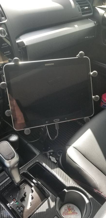

i have one for sale if anyone is interested. slightly modified to work without any stability issues. comes with a ram 10" tablet mount. used for 2 years and never had any problems with it coming loose. DM me.
