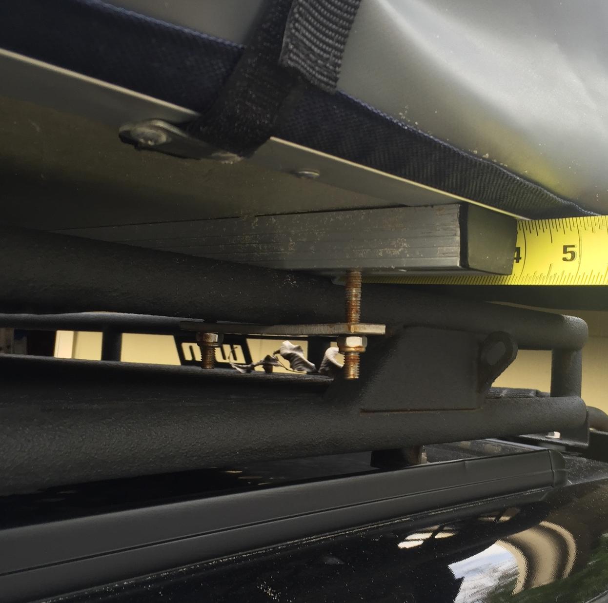

I am hoping to better understand how to mount a Tepui RTT using the Defender rack mounts.
I am unsure how people like Stockwell25 are connecting the defender rack mounts to the mounting racks on the RTT. The videos I have watched about the installation show mounting the RTT to a cross bar on the roof rack and the pictures Stockwell 45 provided are difficult to tell exactly how it is connected.
Click on the link in the OP's post dated 3/26/14. It shows how to make your own cross bars using Unistrut from a hardware store. You would mount the Unistrut to the defender mounts instead of directly to the rails.
Fwiw I have a WMW rack and did this...
