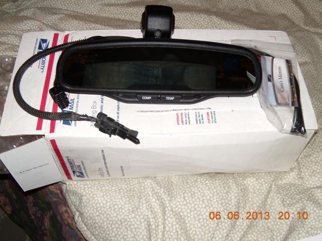

As Rob stated he and his buddy made good on there end of the deal for taking a look at the LC. Today and nice Thank you gift showed up! Thanks guys! Look forward to getting this installed in the 4Runner. Pics to follow.
People like this give me some faith in humanity still. The guys and Gals here are good people if you do not already know this! Hard to find in today's world.
Blue
Gentex 261 Auto Dim Mirror with Compass and Temp | eBay
Awesome! Glad you got it, gonna be real nice in your truck! Sorry for the slight delay since he was so busy moving cross country/halfway around the world lol. Thanks again Brian!
Is that harness long enough?
No but I will fix that issue easy enough. As long as I can get it to the head liner I'll be good and if not then I will work with that also. I have plenty of wire this size. I'll run the Temp sensor to the grill area and put it there.
