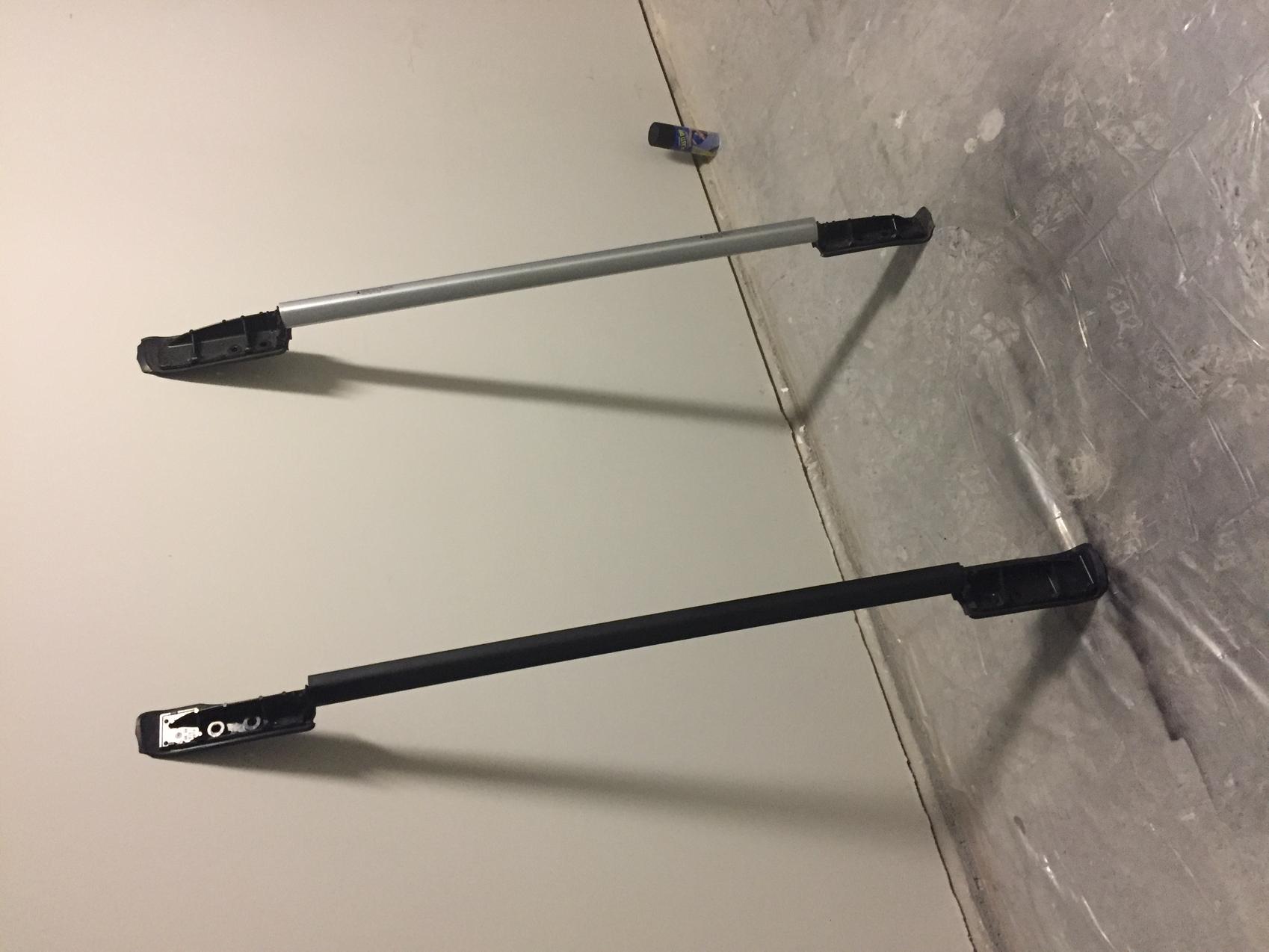

Anyone plasti-dipped their trunk emblems? Roof rack?
Have other pics of front and roof rails, but it won't let me attach more than one pic and I don't want to do three separate posts and get yelled at for "littering". Anyone able to tell me how to post multiple pic would be appreciated.

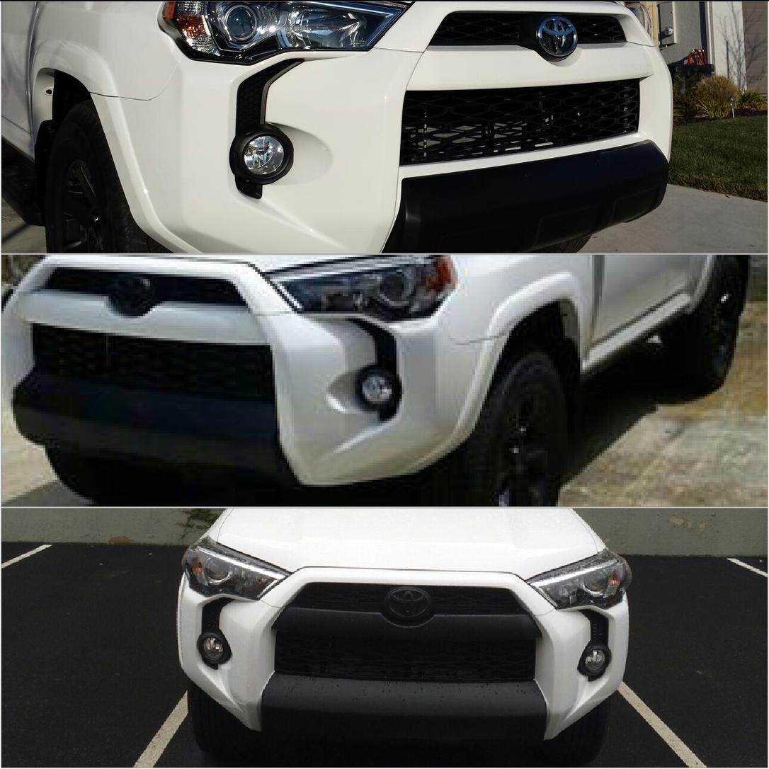

I've done the front and rear silver parts on my TEP and just did the rear chrome and was pretty easy. I'm stumped on what i should do for the front, if anything....
Help me decide, Top (current status), middle or bottom.

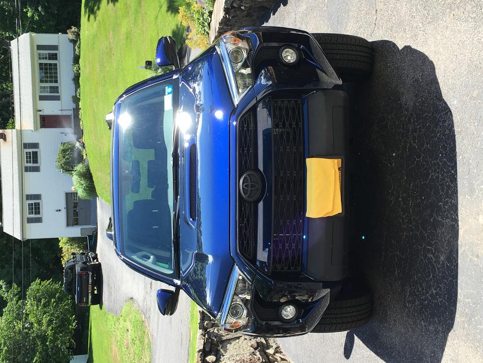

Here's my emblem in gunmetal grey from Home Depot. You don't need to tape too close to the emblem. The way plastidip peels is like magic. I just used a toothpick to start the voids inside the Toyota logo. 30 min between coats and peel it before it's completely dry.

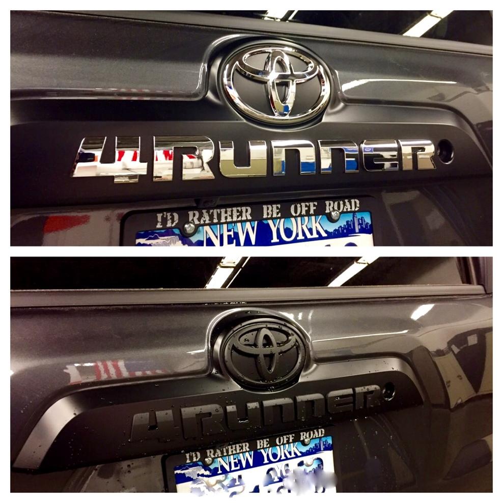

I just used plastidip on my rear emblems of my TRD PRO so all the emblems are blacked out.
This is exactly what I am wanting to do. I love the grey on black.
Can you explain your process? Black plastidip over all the back on just the letters/emblem after with another color?? Or was your valance black to begin with and just did gunmetal over that?
my valance was already black (TRDP).
things to keep in mind for the process (probably already covered, but since you asked):
1. apply 5-6 LIGHT layers of the plasti-dip from a distance of around 8 inches. no single layer should completely cover the emblems.
2. make sure you spray from all angles (top, bottom, both sides). i missed a couple corners of the "4Runner" letters because i didn't spray sufficiently from enough angles. they have since peeled because of this mistake (gonna completey remove all the plasti-dip and start over when i have the time).
3. you'll need quite a bit of time for this project because you need to allow each layer to dry for about 20 minutes.
4. do not worry about overspray on the valance. it will peel off (see #6).
5. once you're done applying the layers, MAKE SURE you allow for sufficient drying time before you start removing the overspray on the valance.
6. go to the drug store and get a cuticle pusher thingy with a rubber end (not the ones with metal on both ends). i found the toothpick method just didn't work that well, the pressure needed to remove the overspray was breaking the toothpicks. applying a good amount of pressure, you will use the cuticle thingy to peel away the overspray, and with the rubber end it will not scratch the valance. this is the one i used:
7. this should technically be #1, but you need to tape off the valance with automotive detailing tape (i found the painting tape didn't stick to the plastic/metal surfaces nearly as well). once you've got the imediate area taped off, start taping pieces of paper (the stiffer the better) to the surrounding tailgate area with the paper.
i think that's it.

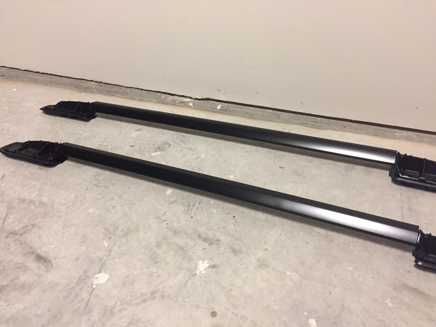

Emblems/logos I used the overlays because I had them but dipped the roof rack, bumper balances and bumper.
I bought the black emblem overlays cause I did not want to deal with plasti dipping them, paid $80 for the overlays on amazon. I did plastic dip my front valance, grill, and used rust-o-leum for the roof rack. Light sand, good cleaning, primer, and two and a half coats of paint. I will be looking to buy the front grille PRO valance and PRO Grille because I hate how plasti dip looks after a few weeks, nicks from rocks and imperfections.
