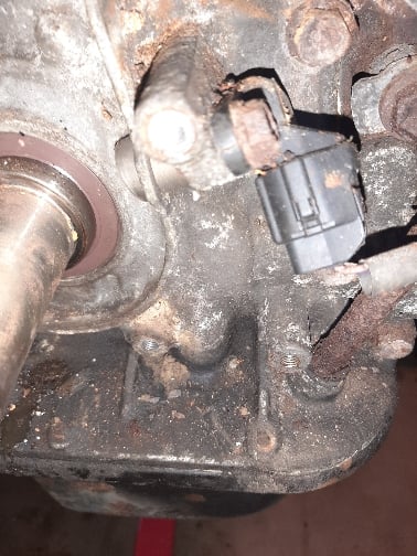

A photo of the crankshaft sensor driver side [grated this with all the timing covers belt etc off]
