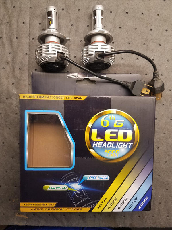

I ran LED bulbs for a very short time and quickly changed back to my PIAA 4000 halogen bulbs. I purchased these on Amazon for about $35 if I recall.
No mistaking, they’re bright and definitely put out the light you would expect from an LED bulb, however here are the reasons I removed them and will not promote them on this board.
  • Too many people were flashing me. Obviously they’re blinding other drivers and personally I hate it when people drive like they own the road with their brights on. You see this more with the monster 4x4 truck group with lightbars anywhere they can fit them.
  • Second reason I removed them was because I couldn’t put the rubber boot on due to the heat sink. This leaves my light assembly completely exposed to the elements.
  • Third reason was because of the lack of heat. Living in the PNW I need the heat to melt the ice away on the light assembly.
  • The tipping point, (which should have been reason #1) was, despite the fact they’re “plug-n-play”, they’re illegal if you use them in the factory halogen based reflector. One accident and they look at your lights, and you’re at fault. LED's are not designed to be used in our factory reflectors.
So for now, IF I ever decide to make any changes, I’ll go the projector route.
Here's a picture of the LED's I wasted my money on. Just sitting here on my bench collecting dust.
BTW: No hate for those that do run them. To each his own and I'm sure you're respectful about using them or dimming them as required.
