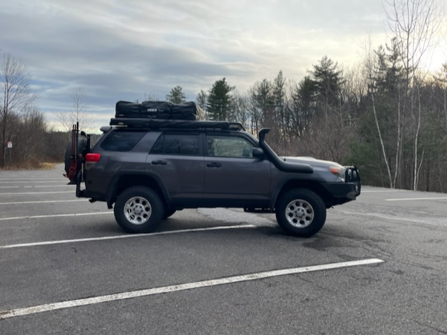

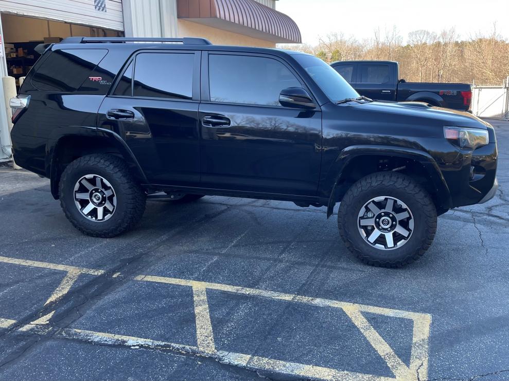

That is the setup I have. I originally got Toytec lift but had to swap the front for OME to support the weight of the bumper/winch. Front is OME 3inch with med springs. rear is 2 inch toytec superflex springs with 5100 shocks.
<a href="https://ibb.co/YyxfHWW"><img src="https://i.ibb.co/F0F8RWW/20221216-080920.jpg" alt="20221216-080920" border="0" /></a>
<a href="https://ibb.co/Y75wtJ8"><img src="https://i.ibb.co/svTzFcQ/20221126-164736-1.jpg" alt="20221126-164736-1" border="0"></a>
Not sure how it will compare to KDSS as I did not have that, but I wanted the stiffer ride than stock as the stock suspension had too much body roll. I have had this lift with JBA UCAs for about two years and 35k miles with no issues.

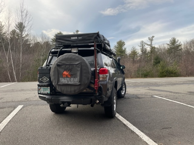

Full OME nitro setup with medium springs, OME UCAs, 255/80 17 Wildpeaks on 2015 Trail with KDSS. Love it. Great on and off road. Putting Hefty Banshee bumper and winch as soon as the bumper is built.

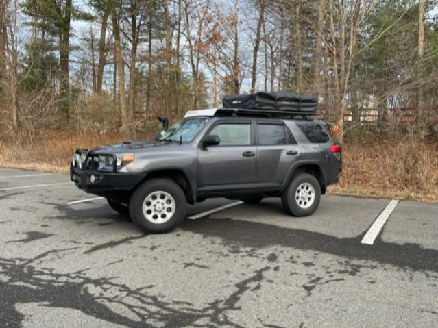

OME HD lift with 255/80/17 tires and have been happy with it. Has handled the weight better than previous bilstein set ups I’ve used in the past

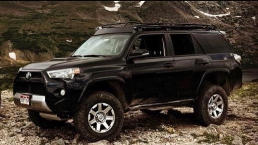

Well I pulled the trigger and went with the OME medium duty setup and DK upper control arms with 287/70/17 tires on OEM trail wheels. It came out exactly how I wanted it to as far as ride height. Zero tire rubbing forward or reverse at full lock, and while being a bit stiffer and bouncier on the highway, I like it better than the sloshy body roll and nose dive characteristics it exhibited before.
