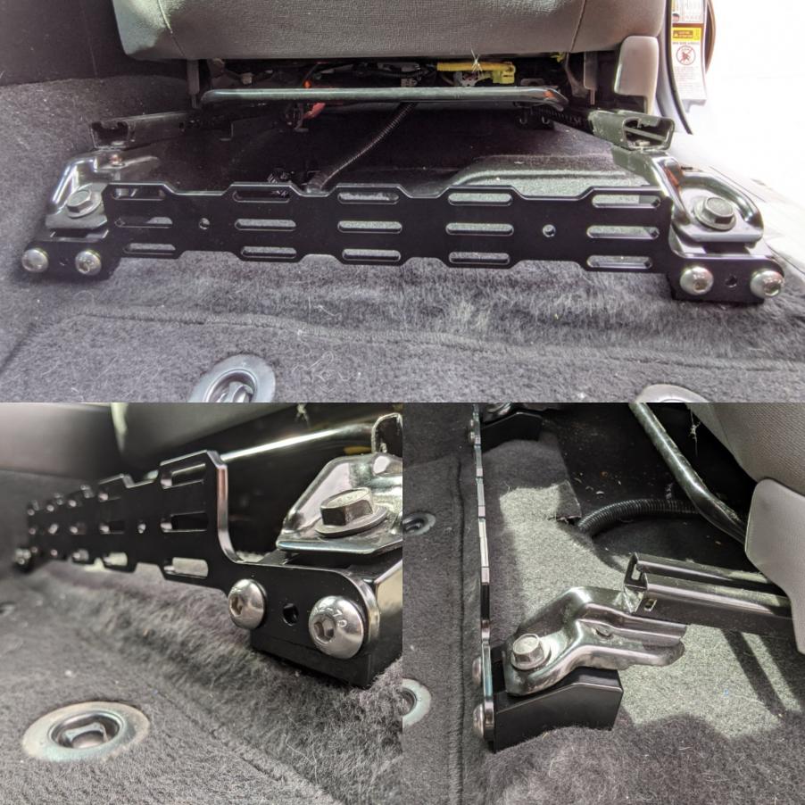

How much trimming was involved? Saw the note on their website.
*Please note that when installed in 4Runners and GX470/470s, removal or trimming of trim pieces may be required.
I didn't have to trim anything. I'm not sure what would require it?
I'm 6'5" tall and the front seat jackers did not affect my seat height or headroom. That was one of my concerns since I have a sunroof. Changing the angle of the front seat bottom for the increased thigh support made all the difference in the world.
I'm not as tall as you guys are (6'1") but I did keep my seat pretty high. The seat jackers enabled me to completely change how the seat was positioned. I was able to lower the seat considerably and raise the front up much more so that it supports my thighs much better. I was also able to change the seat back to be a bit more vertical which supported my back and lumbar much better. It really does feel like a completely new seat as someone said. Shame I didn't have this 7 years ago.

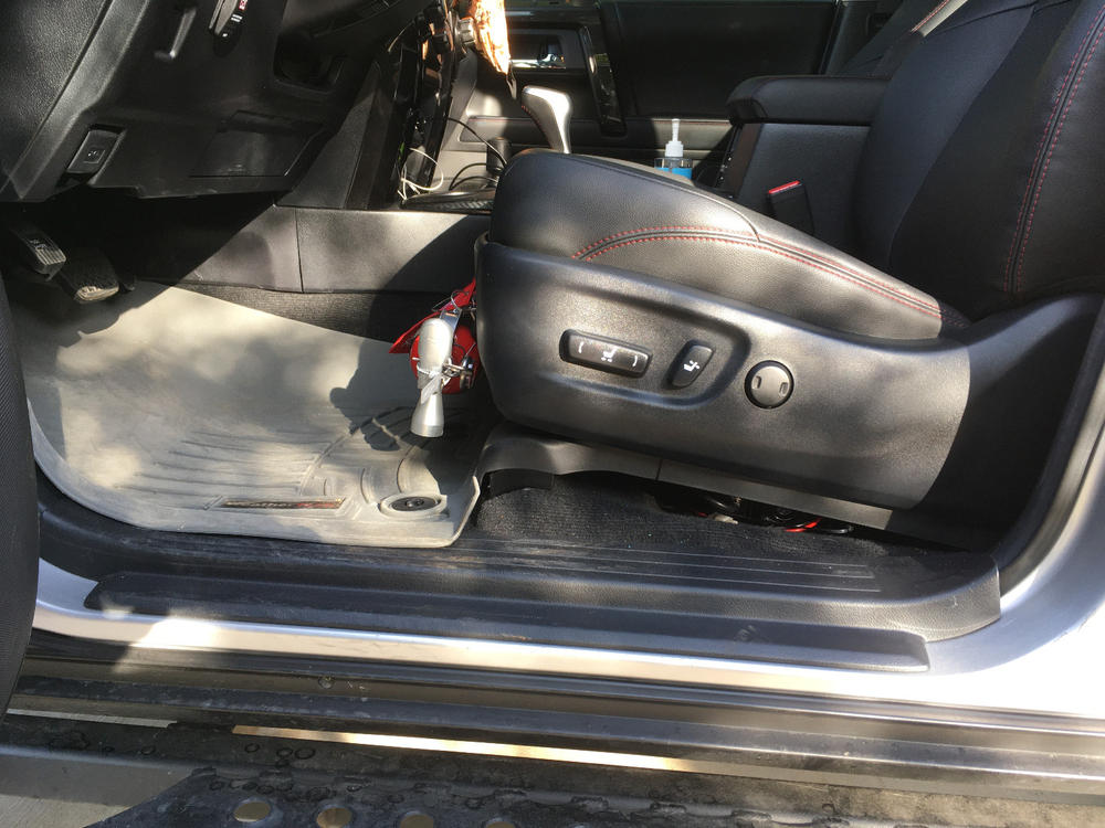

I think it's in reference to the black plastic piece that hides the seat mount bolts. I simply removed them on mine.
I've had the passenger side covers removed for my wit's end fire extinguisher mount for 3+ years at this point with no issues. I guess now they match at least?
ok that's interesting. I didn't have to trim my caps to get them back on. They are a bit raised from the floor but no problem with fitment. Maybe the caps changed design at some point. I do have a '13
Oh and I only did my driver's seat so maybe the rear seats or the passenger seats?
Interesting feedback, I was wondering about the trim removal as well but it makes sense that they would snap back on, as long as you skip the accessory panel. Once that's on either the front or rear of the seat I could see how the trim would have to go or at least be cut.

I recently installed these on both front seats. No need to remove or trim the plastic pieces because I didn't add the molle panels. That's where I think you get into a fitment issue with factory trim.

LOL...Yup, I've done so many little tweaks like this I've lost track. I was exploring options to mount an extinguisher behind the passenger seat, accessible but out of the way and
boom..."seat jackers"...WTH
