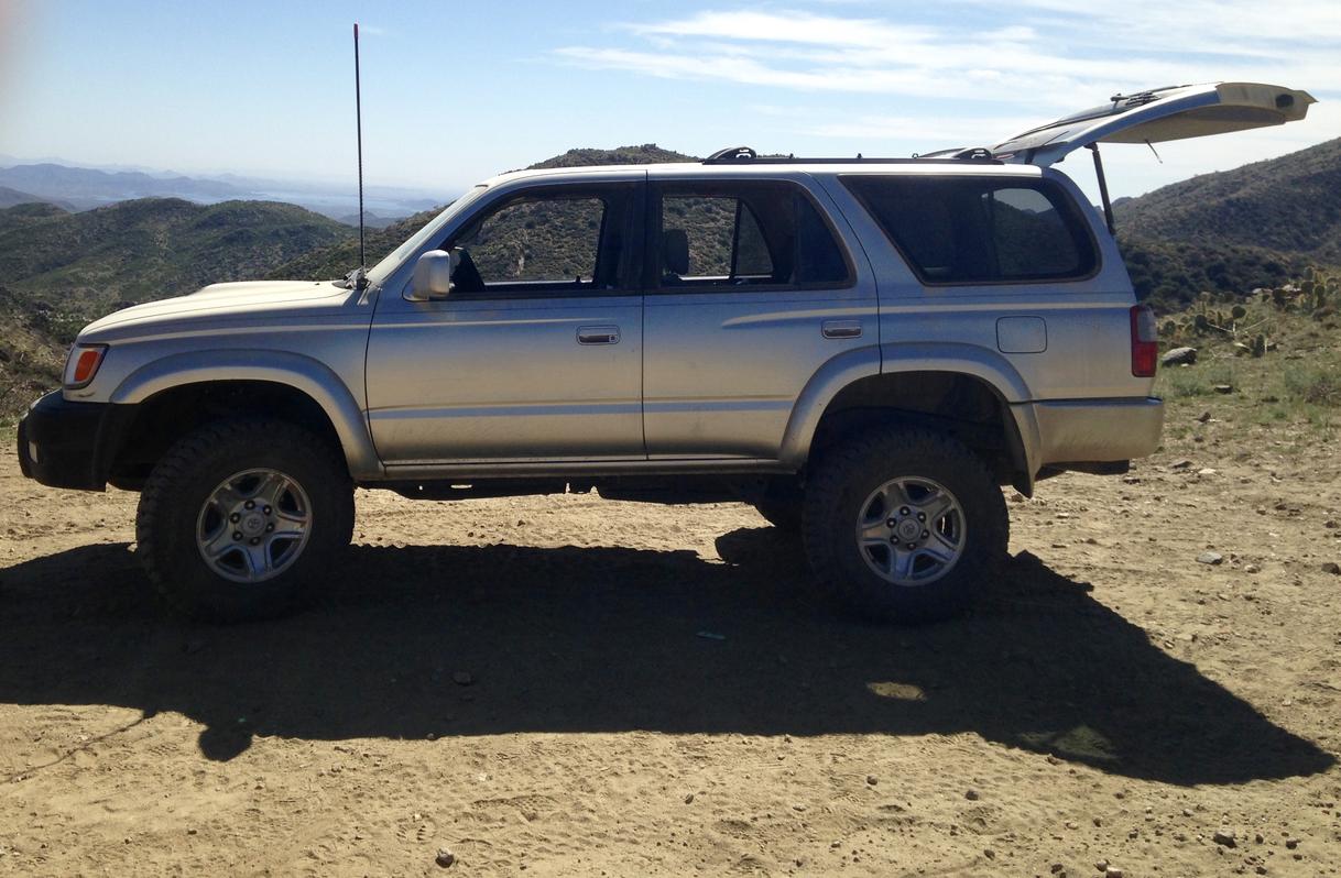

I have the tundra Billies up front but run Tacoma coils Passenger on 3rd driver on 4th perch for lean. Im pretty sure I have 8wraps from an LC80 out back with Monroe LC shocks. I'm a cheap ass so I got either freebies or craigslist finds and warehouse deals from amazon for the billies. I was going to spend on the SS but some folks talked me out of it because you can pretty much piece it together for way less.
This is how it sits unloaded.
