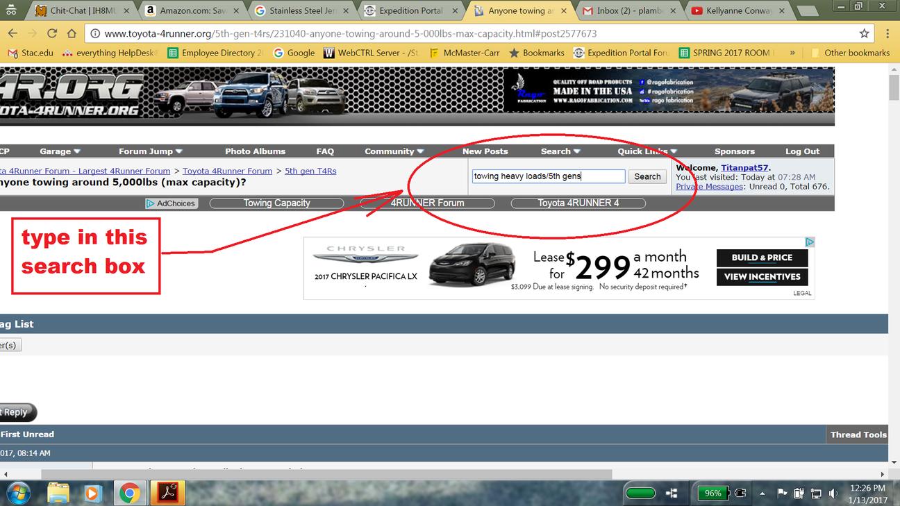

As far as searching....at least 10 pages, probably more
so for you own edification [MENTION=56532]MSBX4RUNNER[/MENTION]
