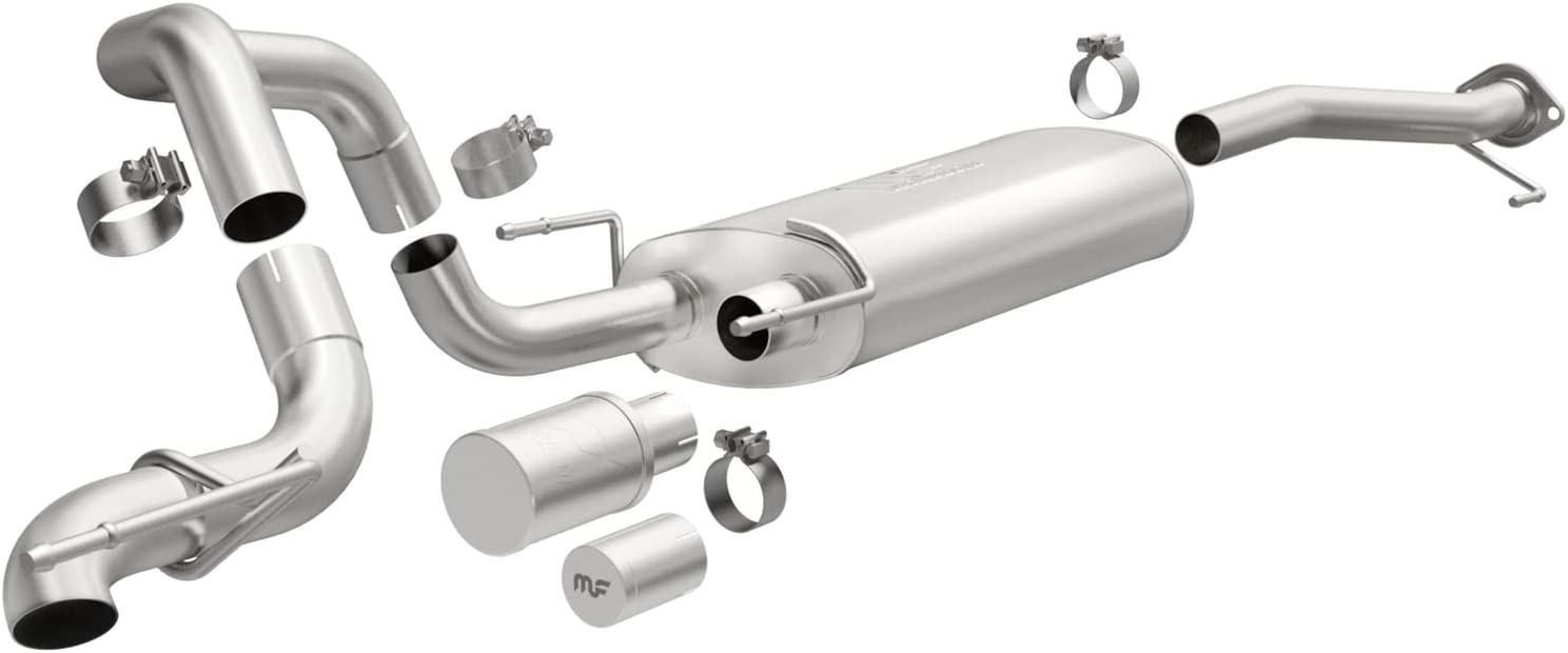

Looking to upgrade my exhaust on my 4th Gen 4R
Looking for any recommendations or cautionary tales if anyone has done this to their 4Runner.
MagnaFlow Cat-Back Performance Exhaust System Overland Series Kit 19546
Amazon.com: MagnaFlow Cat-Back Performance Exhaust System Overland Series Kit 19546 - Designed for the 2003-2022 Toyota 4Runner - 2.5in Main Piping, Single Passenger Side Rear Exit, Dual Satin Mufflers : Automotive
They claim it gives a signature deep tone and features No Drone Technology, which cancels out the natural droning frequencies of the V6 Toyota 4Runner.
It also sits up higher offering better clearance.
Before I pull the trigger, any advice RE: installation, performance, etc... would be welcome.
Thanks!
