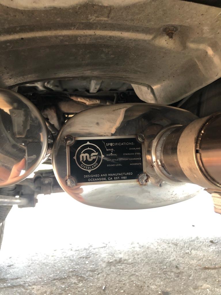

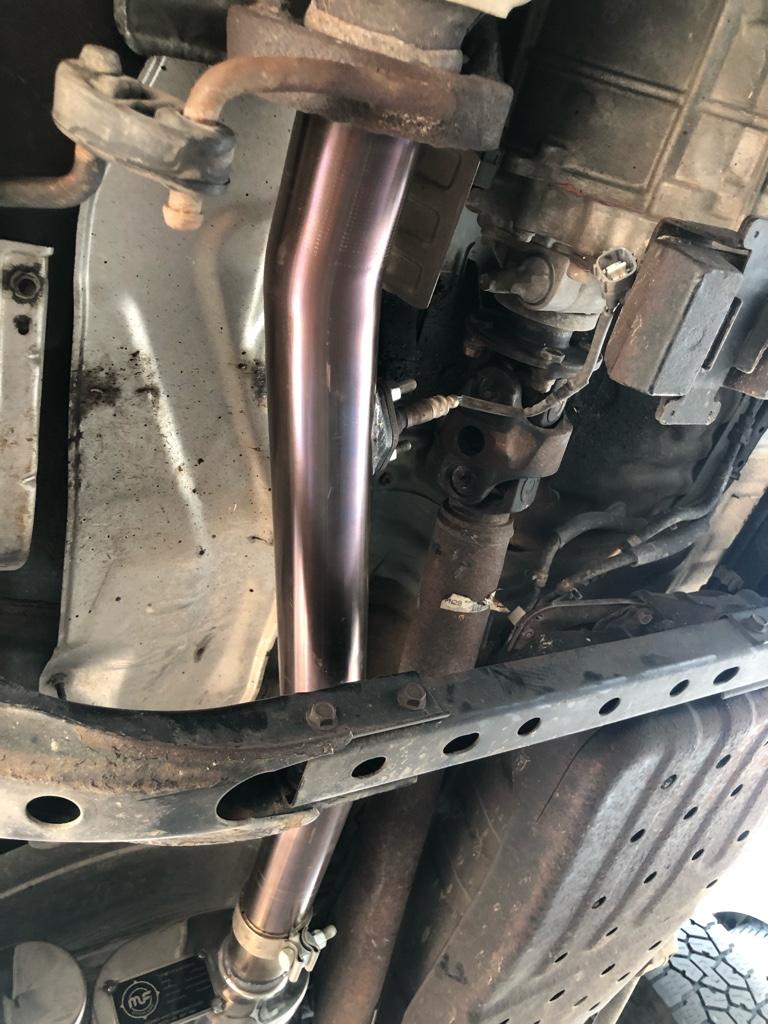

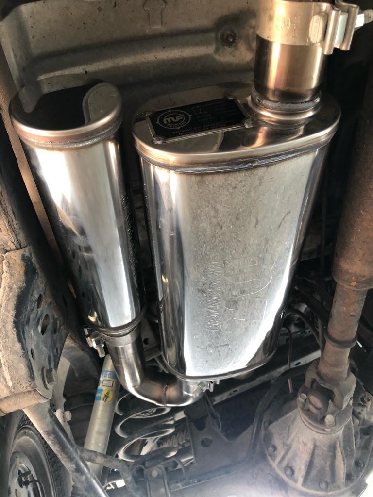

Installed the new magnaflow overland car back exhaust today. If anyone is questioning whether to get it, it’s 100% worth it in my opinion. Install was super easy and build quality and fitment was excellent. I installed it with the j-tube and resonator (quietest option) It sounds great and might be my favorite mod I’ve done to the rig thus far. It’s amazing how the heimholtz resonator really quiets it down at highway speeds. Pics below.

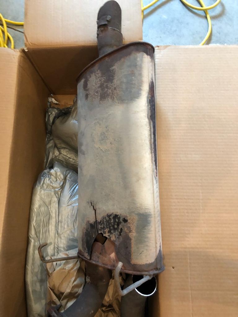

As you can see the old aftermarket muffler that the previous owner installed was very tired lol.

Great photos, thanks for sharing!
Good lord, I wonder if the muffler was even muffling at that point :lalala:

Haha I took some videos from inside the cab before and after it’s a night and day difference in noise. But yeah the old muffler was super loud and had an awful rattle at idle because of all the broken metal inside lol. Get it man, it’s well with it IMO!

How’s it sound? It’s kind of a cool feature to be able to take it off and cap it or run the j-tube at any point if you ever wanted it louder/quieter for any reason.
It sounds kinda, uh, 'loud' just capped but it's all subjective. The most extreme would be uncapped. That's the cool thing about cat-back flange bolt-on - you're not stuck with whatever is welded on. The option to try different configs is one of the best things about the MF Overland kit IMO. Made in USA, too.

I thought I'd chime in with my experience. I have stock springs with Bilstein 4600 and the exhaust would bump into the rear axle housing on full compression. The exhaust is really made for at least a 1 in lift. The springs have less than 3000 miles on them, and there's no sag in the rear. I didn't want to buy new springs with a 1 in lift, or an oem exhaust, so I just removed the spare tire to give that additional half inch clearance. Added benefit is that I think the spare tire acted as a loudspeaker bc the exhaust has quieted down with its removal. I actually thought it was too loud and regretted my purchase, but it's more tolerable now. p.s. I couldn't use the spare tire anyway bc my tires are upsized one size so the spare no longer matches the rest of the tires. hope this helps someone.
