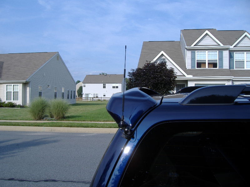

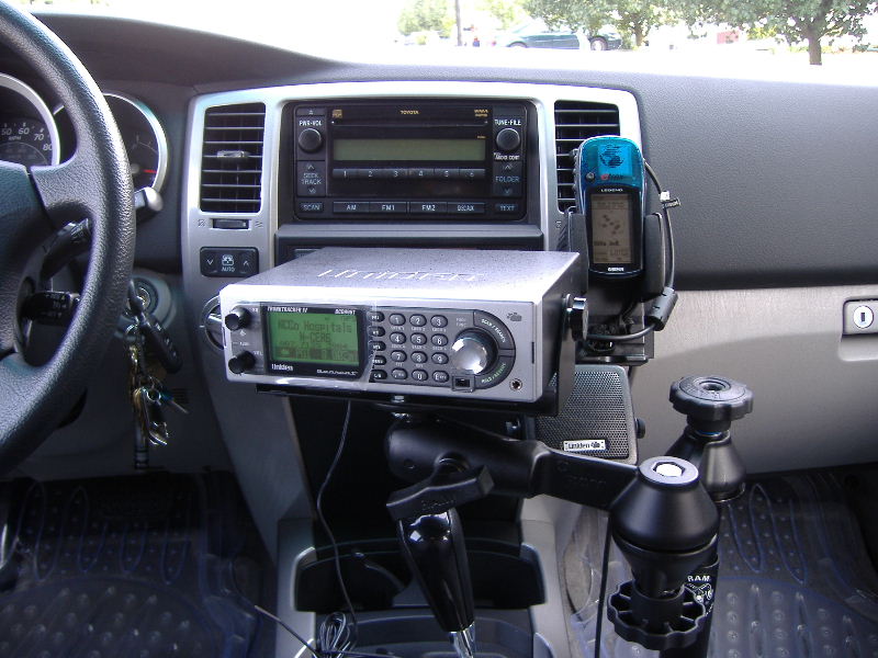

Hello,
Here are some photos of a RAM-Mount with an Uniden BCD996T Scanner, a Panavise Mount for GPS, and a Diamond Antenna Hatch Mount for a NMO Antenna. The RAM-Mount can be used for any type of two way radio (2 Meter, 6 Meter, 70cm) or you could purchase a radio with remote head and mount base anywhere.

Ahhh, very nice. How big is that ram mount? Whoa! How is it attached? I've been thinking about getting a radio to monitor 800mhz down here in Los Angeles. I volunteer with LAFD and sometimes I don't get the greatest of reception on my handheld scanner that you noticed. I would like to get a scanner with a remote head or I can go the cheap route and just buy a antenna and connect it to the handheld via a bnc connector. I'm using a 1/4 wave antenna for gmrs, it's only about 6 inches.....for 800mhz it would be probably double the length. I do like the way your antenna is mounted. What's the price on one of those mounts? I also have a mount now for my Garmin Nuvi.....I should probably go take a updated picture...brb.
The base of the RAM-Mount attaches to base of passenger seat. It is heavy duty and used for laptop mounting but adapted for radio use.
I have Uniden's BC-RH96 Remote Head for the BCD996T or BCT15 Scanners, just have not mounted yet. I will use the second glove box to mount scanner.
I recommend Wilson Electronics Cellular Attenna found HERE. The best antenna for 800 MHz reception. You will need a FME to BNC Adapter.
Its about $60 USD. It is Diamond Antenna model K412CNMO Trunk/Hatch mount for antennae up to 45". Its for folks like myself that don't want to drill holes in new trucks. :D
