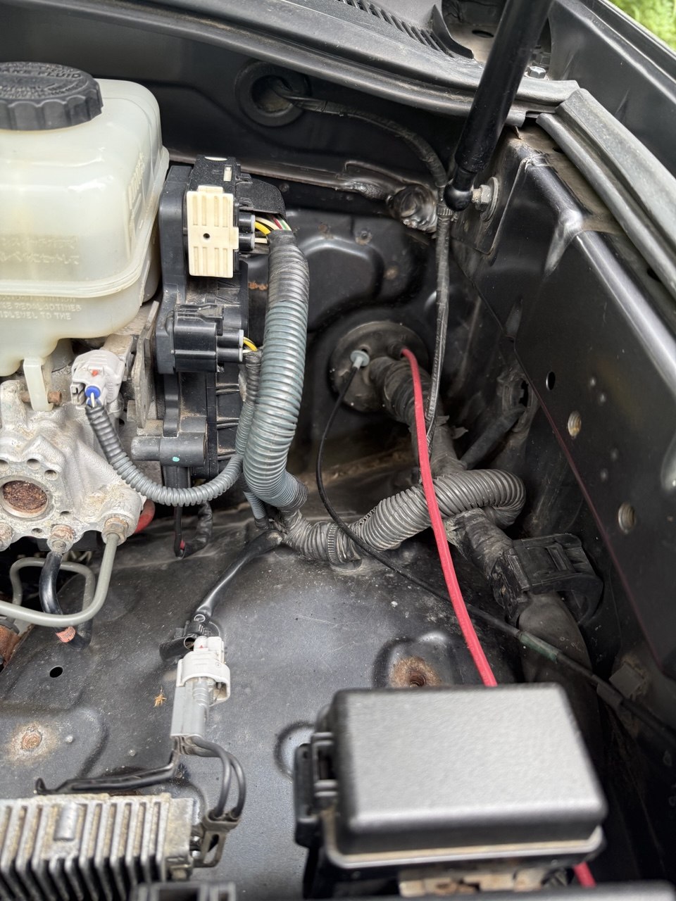

There's a grommet on the battery side of the firewall so you just go battery -> right lower side -> firewall grommet and then inside the cab you can thread the wire up and over the steering without even pulling any panels, then thread up into center console. You should be able to do the entire run with only pulling the center console which takes 2-3 mins. I have a run from the battery to the rear powerport for my fridge to replace the stock wiring and outlet, it was ezpz to run. Let me know if you want a photo of the wire in the grommet.

Yeah, a photo would be appreciated if you can find the time.
Red wire. Suuuuper easy. Just don't forget to add an inline fuse.
