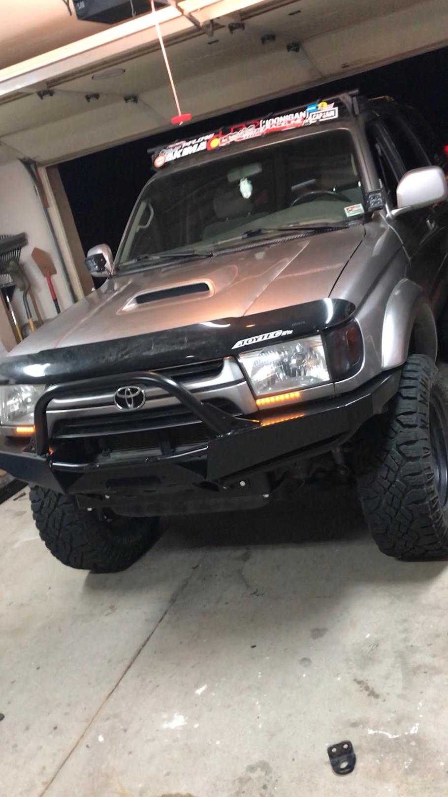

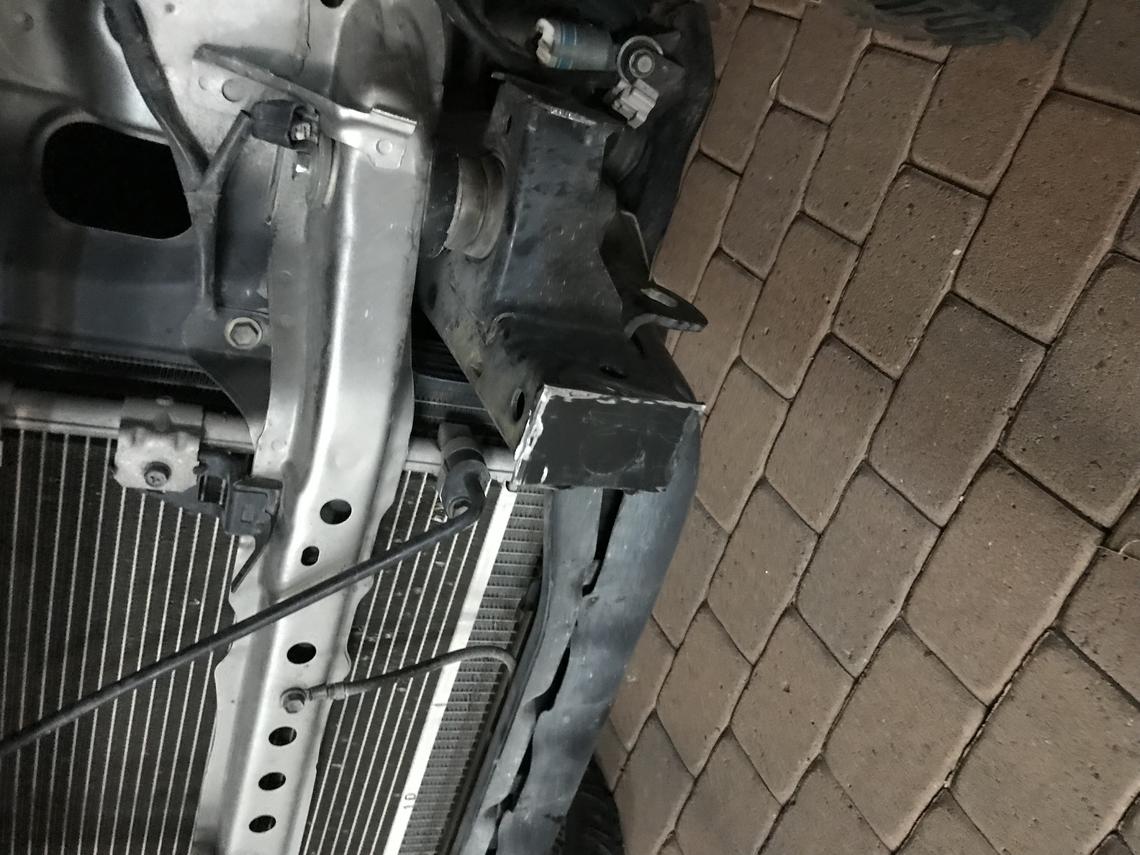

Installed mine a few weeks ago. The install should only take about an hour if you have an angle grinder to cut off the stock mounting brackets. If I can do it you can.
