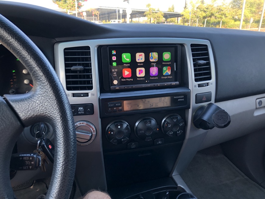

I just recently added CarPlay to my 4Runner and settled on the Pioneer MVH-1400nex
I went with it over the Alpine you posted because I liked the look of the side buttons (it kinda matches the stock system in my 2018 Civic) and I like the interface of the Pioneer better.
But the big things for me were to have a capacitive touchscreen, and USB in the back for clean install.
I also bought from Crutchfield and got them to do the wiring with the steering wheel controls. My T4R does not have the JBL system so I got the PAC steering adapter. Crutchfield did the wiring well, just note that you may have to program the PAC unit to your liking yourself. It took my father-in-law and I about 15 minutes to figure out how to program it, but we got it done. One thing that sucks is that you need to press a button on the PAC unit to program it, so your headhunt is going to have to come out to reprogram if you want the buttons to do something different.
Since we are going to use mostly Apple Carplay on this thing I programmed the buttons like this: Vol Up, Vol Down as normal, seek buttons for track next, or track last, and mode I made a long press be the voice button so Siri comes up when I hold it down.
Also, Crutchfield does not include parking brake wiring or a bypass so I had to get one of those and wire it in so that all the menus could be accessible.
Here's what it looks like installed:
and I also bought one of these to put a usb port in the console: https://www.amazon.com/gp/product/B07G757Y2D/ref=ppx_yo_dt_b_asin_title_o02_s00?ie=UTF8&psc=1
Then I took an Add-a-Circuit and plugged it into the accessory spot on the fuse box to wire up the power only for the other port. Works well for now with CarPlay and power
Really clean install. Im literally planning on doing the exact same thing as you except my runner has the JBL system so I am going for the iDataLink Maestro. My one question for you is what did you do to bypass the parking brake feature?
