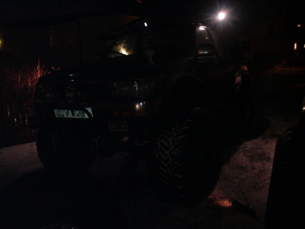

But, I took some pictures while on my workshop earlier this evening.
Shows a little bit of the interior and maybe a little bit more of how he looks in light, I still have somethings left, like lowering the front suspension about 30mm and moving the rear axle 150mm more backwards.
I'm gonna try to get them online before I go to sleep.

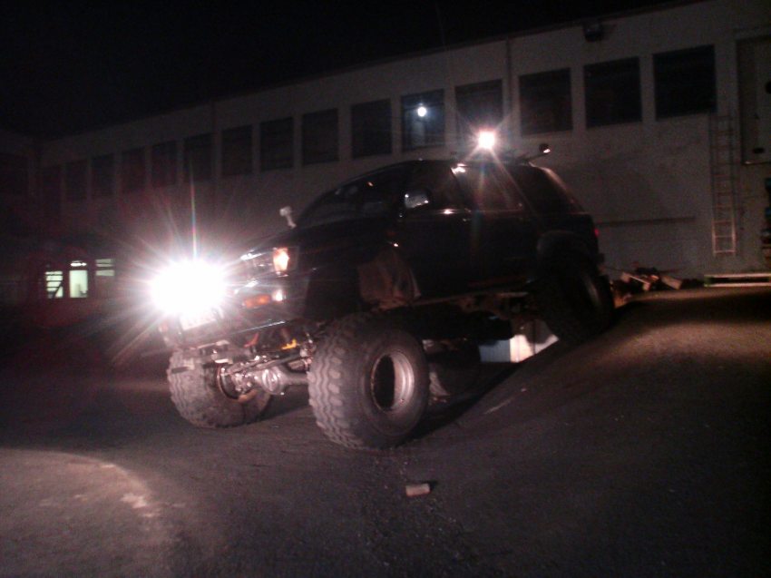

oops..
I was tryin' my new DC/FC 44s. Needed to see what I need to get done in the rear so it'll fit nicely.
Not a great pic, but I was doin' this outside in the middle of the night in -10 degrees on celcius. (Sorry for you Fahrenheit guys, I don't have a calculator right now).
NOTE: DC on the left side of the car, 38" Mudder on the right side...

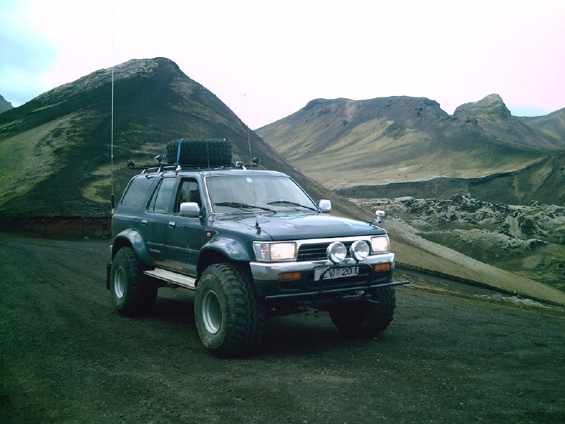

One daytime picture?
At a trip in August. One week of drivin' in the highlands of Iceland. This pic is taken close to Landmannalaugar.
Running 38s, IFS still on and my spare tire on top...

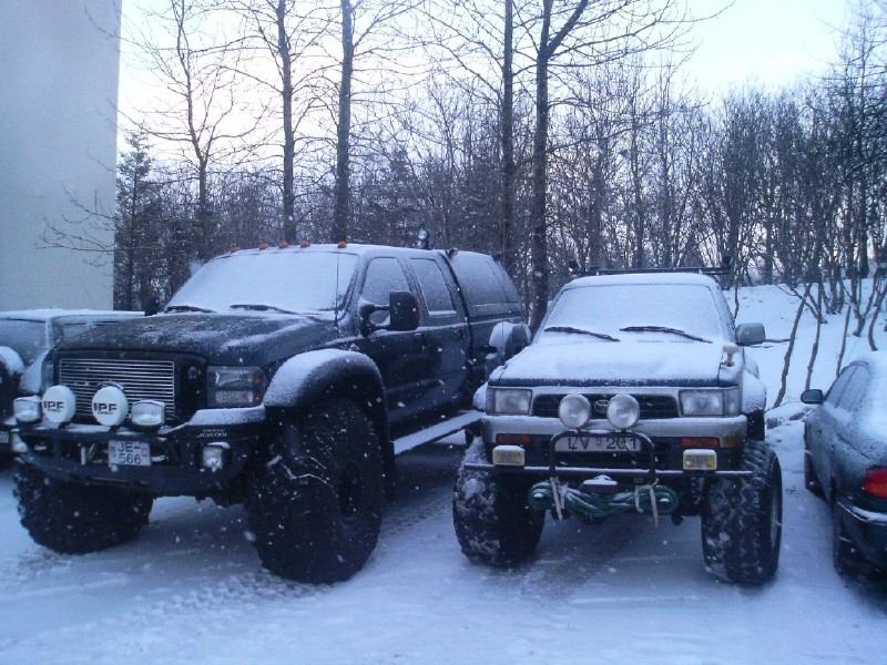

My 4Runner on 38s is like a mouse next to a elephant when you see it next to the 49s Ford/Dodge pickups...
I have a pic of that at home, Maybe I'll post it later tonight.

But back to topic, here's one of my "Yaris" next to a full size truck. lol
