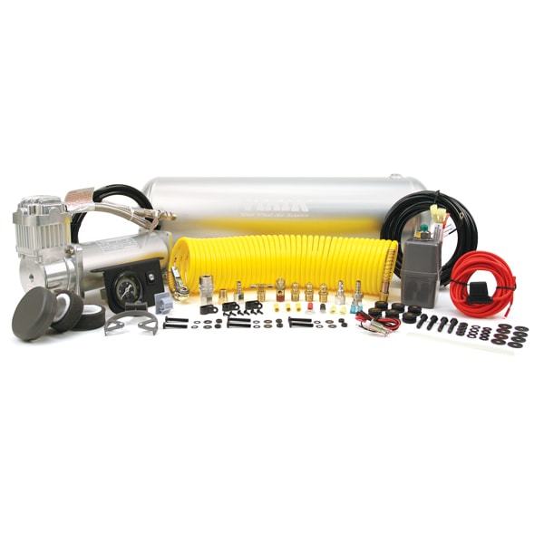

Initially I bought a viair constant duty like this but it was too big to mount and finding a nice case to make it into a portable setup was not happening so I sold it. Either way you end up going, having the tank makes all the difference. Super fast fills and powering pneumatic tools is awesome
