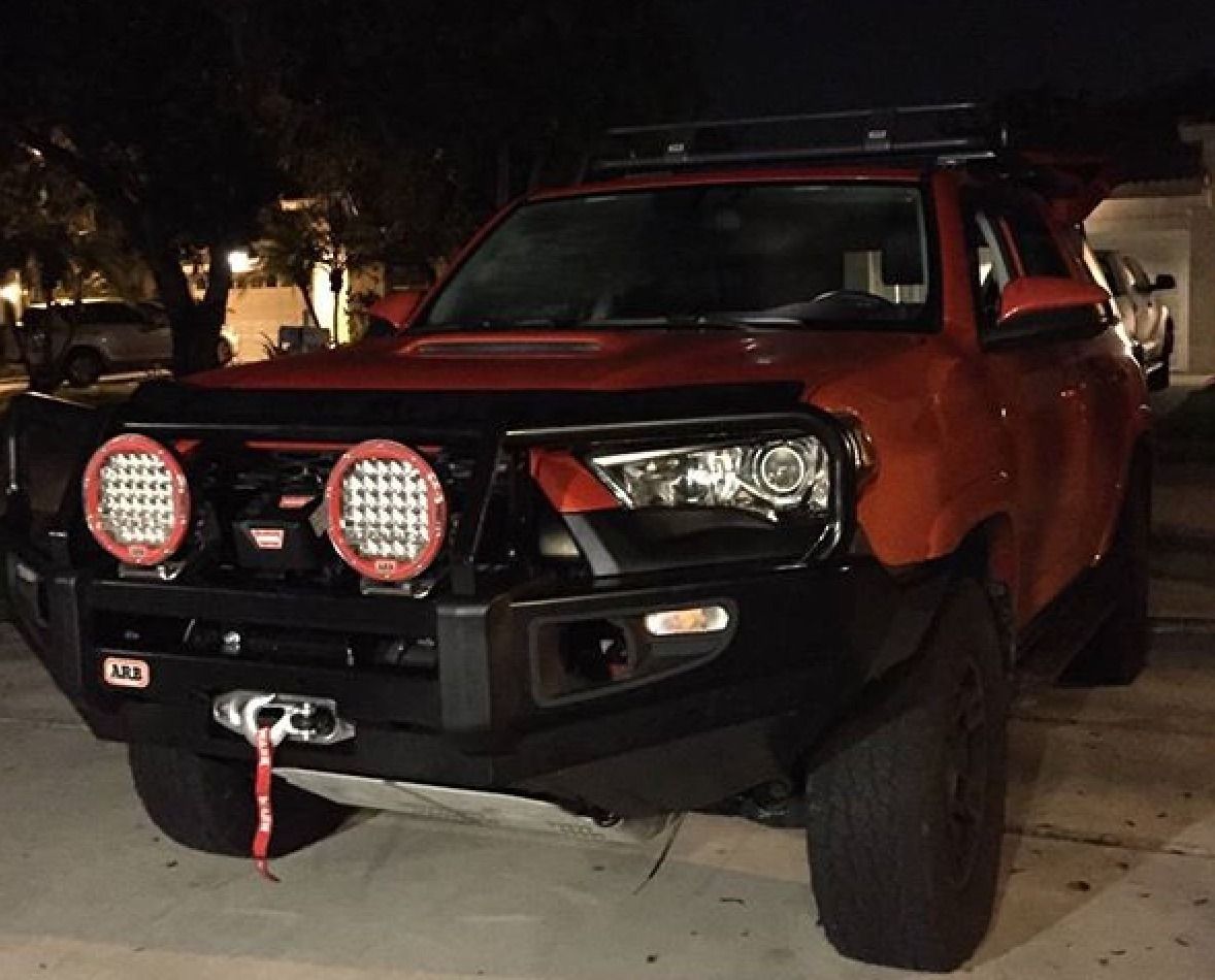

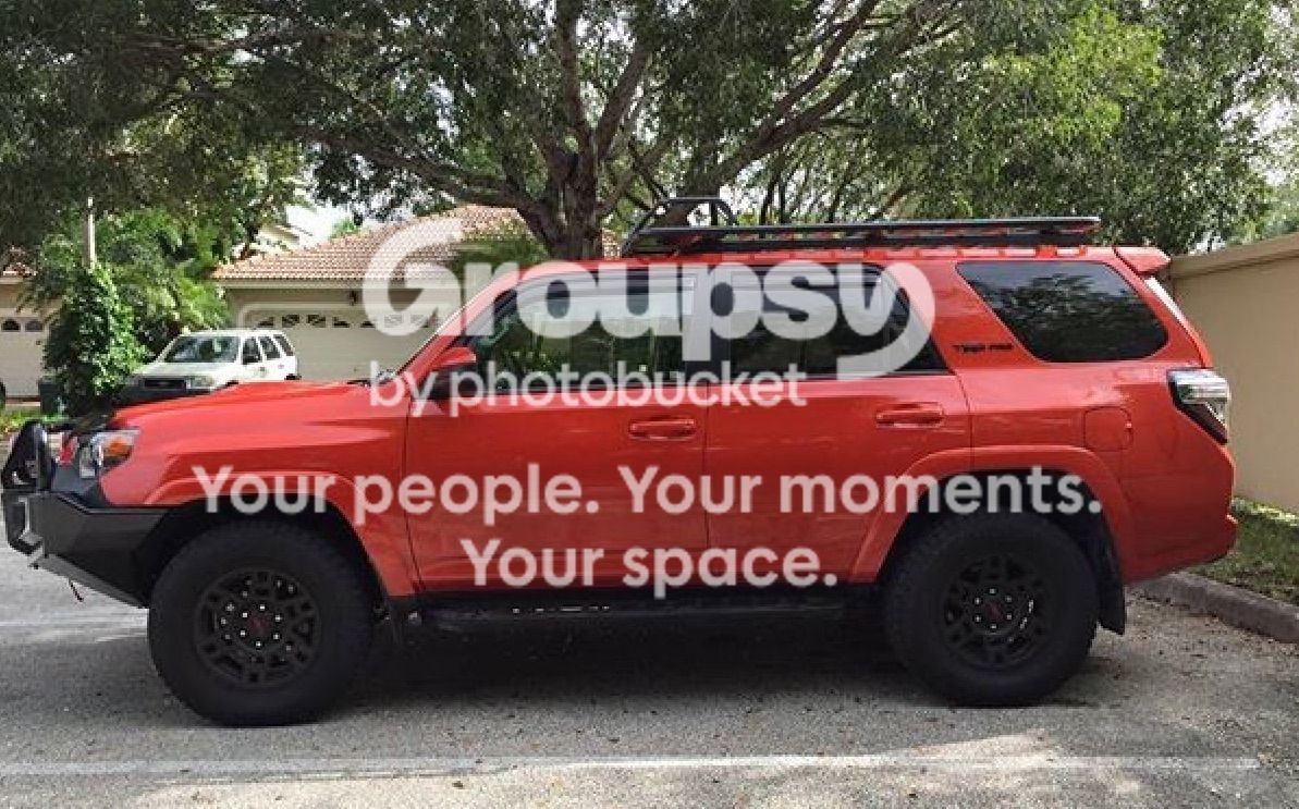

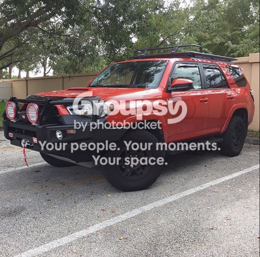

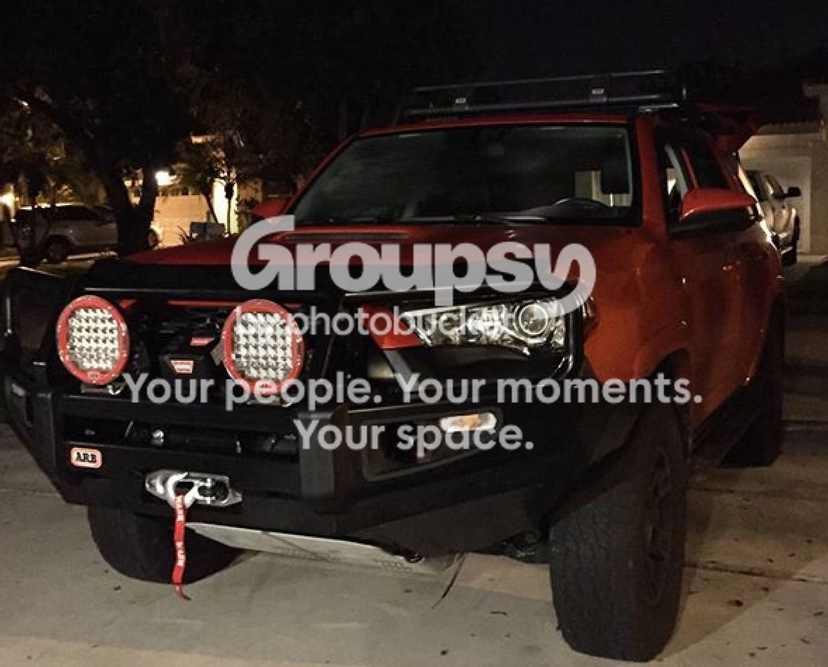

I've done it with no issues using a combination of parts. Front coilovers have to be changed. Contact me in Instagram MILOWILLI if interested.
Thanks for the reply, I figured there would be a need for bigger springs, but being that I'm new to Toyota (Former Land Rover Guy) I know very little about this truck. I've been looking at the Southern Winch set up that you have which looks great by the way but when i compared costs I leaned towards the ARB. How was the install?
Yes you will need an adjustable coilover..Not BILSTEIN OR OLDMAN EMU!!
Fox, King, Icon..to adjust and fine tune the ride height.
