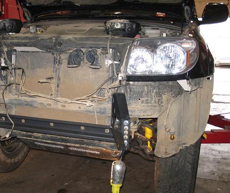

I did install ARB with my friend. Its 200lbs, so it would be easy to do it yourself, but most of the work can be done by just one person. If you work in pair, it wills significantly cut your installation time.
Yes, it's awesome. It
200 pounds? are you serious?
my tjm is less then 100 but not much.. thats one heavy bumper inless you included a winch on it.. then I could see 200 easily..
ARB is replacement of your old plastic cover, reinforcement bar and bumper brackets. I think all this weights approximately 70-90lbs. ARB has new brackets to the frame and steel bumper itself, no need in reinforcement. 200lbs is not that bad. My front end is sagged something 3/16". ARB is more engineered bumper compare to TJM. It's been designed not only withstand off-road driving, but also provide at least the same level of cooling and make it look stock. Right now when I'm looking at the front of my truck it doesn't looks like some aftermarket accessory (TJM, Shrokworks does, my personal opinion), it seems to be designed and assembled by Toyota.

Search the forum tomorrow. You'll see the 1st part of the review.
To answer your question, see attached image. This is ARB sub-frame brackets installed. Detail review is coming...
