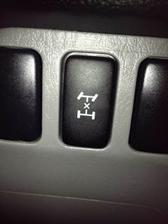

Hey guys and girls I own a 2003 4runner and am having a ARB rear locker installed . Being new to wheeling I am curious when I have the Locker engauged do I still use the centre locking dif button ?

Depends on the terrain and what you are trying to do.
Yes for crawling, no on a dirt road when you want to get sideways.
I guess what I am wondering ? Will I still have three wheels under power even with the centre lock button not pressed? and just the rear locker pressed? pressed?
Without the center diff lock pressed all the power could still be transferred to the front wheels, so in order to use the rear diff lock to it's fullest, in my opinion, you would need to lock the center diff. You should use the center diff lock well before you need the rear diff lock. General trail cruising the center should be locked, when approaching a ledge or hill climb, hit the rear locker too.
Rule of thumb for order of engagement should be center, rear, and front (if equipped).

Keep in mind, the center diff lock just locks the front and rear axles into the same rotation/power to ground sequence. This is not the same as an axle locker, two completely different functions and uses.
I’ve never heard of this type of V8 4Runner, but you’d be fine as is, unless you plan to off road in some more wicked environments to where you’d need both rear wheels pulling together.
