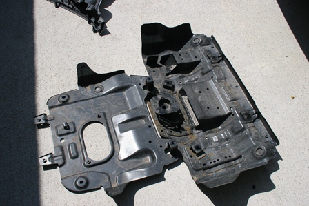

If you look at the stock front skid plate, there is a steel tube that transfers load to the frame. Because of that lack of support on the ARB, the front skid will crush with even a small fraction of the 4runner's weight resting on it, and tear up the mounting tabs.
The rear mounting of the transfer skid is a weak L bracket that will interfere with the exhaust crossover and rattle, right out of the gate. It gets worse as every time the transfer skid hits anything, it reduces that clearance further. When you get a much larger piece of angle iron to replace the L bracket, the tiny mounting bolts that go into the cross member will simply shear off.
I'm generally a fan of ARB products, but their skids are worthless. The OEM skid plates are better.
Correction, it is not the transfer case skid, it is the trans skid which contacts the cross over pipe (directly in front of the cross member on this FJC, behind it on the 4runner). You can see the wimpy L bracket here and the 3 10mm bolts that will shear off. Almost forgot, the "transfer skid" is that joke bolted onto the transfer case itself.
In the center, rear of the stock front skid, is the part that transfers load to the frame cross member.

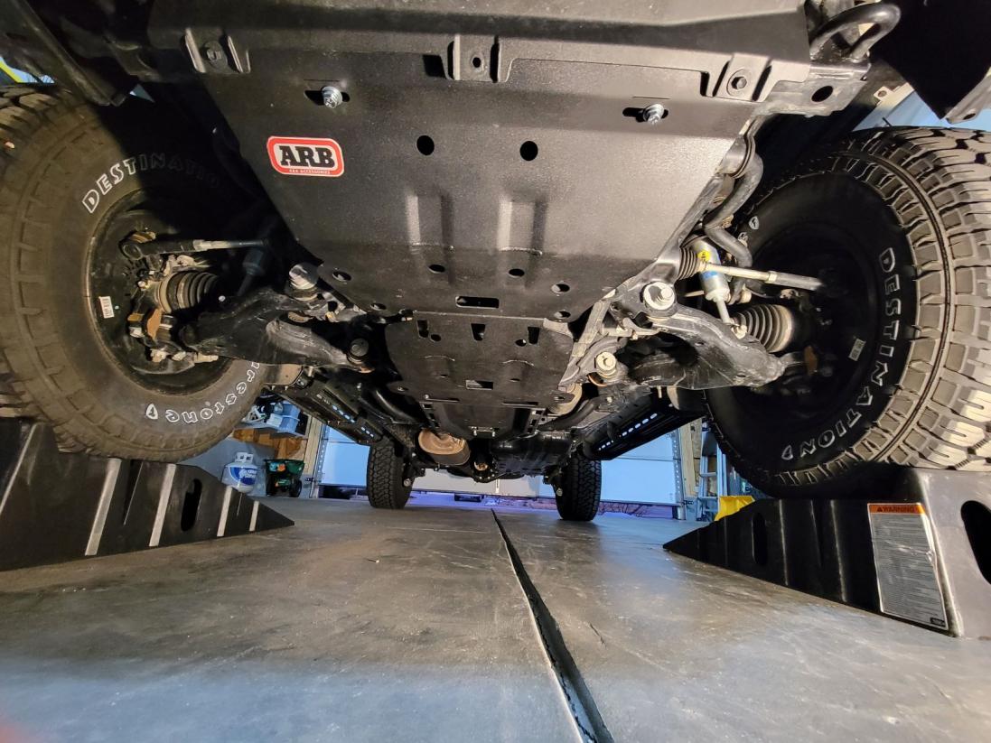

Installed the ARB skid plates this evening. I painted them with Rustoleum bedliner... I just didn't care for the light gray, besides it makes them easier to touch up.
I also wonder if they haven't changed the design a bit given some of the older reviews. The transmission skid included a piece of square tube which bolts to the skid and contacts the frame crossmember. Thus, adding additional support to the bracket and keeping the skid from contacting the exhaust crossover. In fact I might do something similar to the front skid (similar to the stock skid) depending on how things appear to be holding up.
