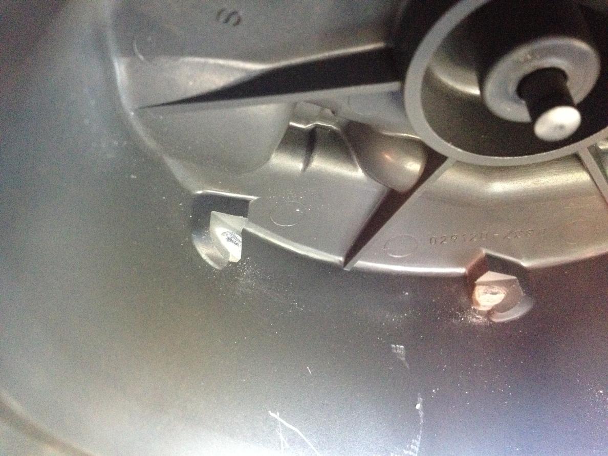

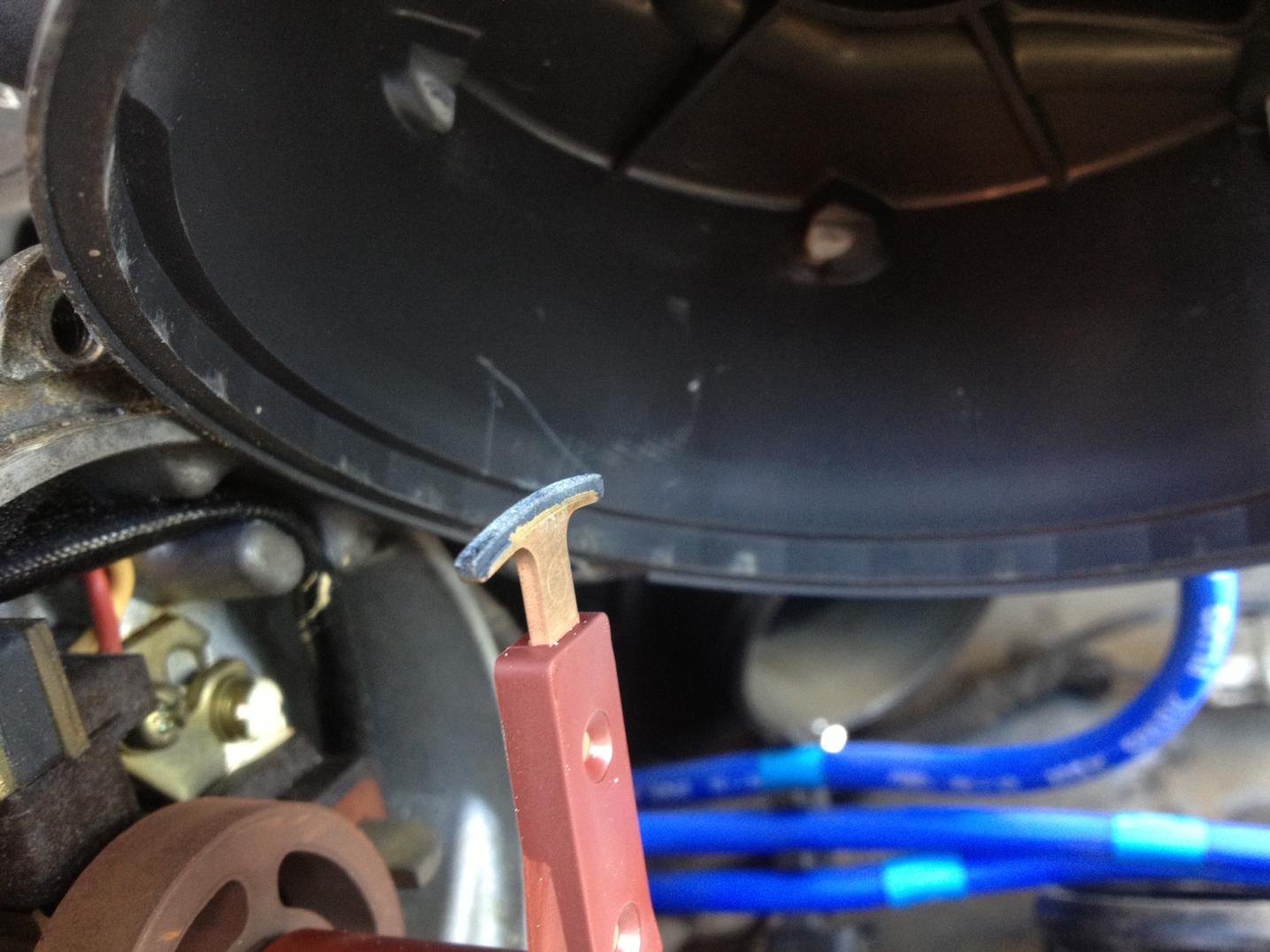

Here are some pics.

For good measure you may want to get a scotch pad and clean tht rotor.
Clean up or replace the cap and rotor and see if it runs.
That'll help determine if the problem is related to the battery arcing or not.
