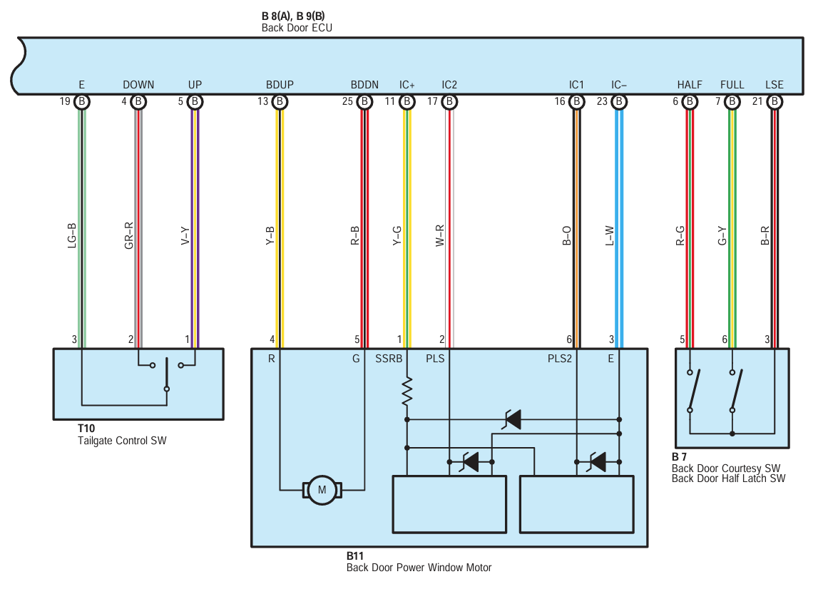

Not following a tutorial, just building on this wiring diagram. The rear key lock on the hatch ("Tailgate Control SW" on the diagram below) isn't really a lock but just a switch that closes a circuit between ground from pin 19 to either pin 4 or pin 5 on the back door ECU.
Pin 19 just provides ground, so you can just connect pins 4 or 5 to any ground on the vehicle.

To follow-up, replaced the Back Door Rear Gate Window Motor and the Tailgate Power Window Regulator - still not able to initialize the rear window. I suppose that leaves just the ECU and the wiring harness next.
Update: replaced the back door ECU, now I'm able to initialize the rear window and everything works. Rear window goes up and down very smoothly and quietly with the new window motor and regulator.
