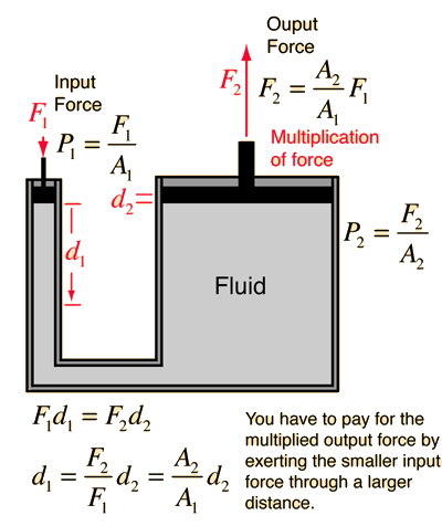

Larger Pistons in the 5th gen calipers mean a greater force applied to the rotor for the same petal press..see figure
Pistons placed further from center of rotor means more stopping force..torque=force*distance...like using a larger wrench to break a bolt

I'm curious how much of a difference in force you'd see by increasing the piston diameter 2~3mm? Since basically everything else in the system will be relatively the same save for that?
Very little I would guess..but that combined with the greater moment arm and cooling capacity give it a poor man's big brake kit appeal. I'm weighing my options now since my rotors are just about shot.
