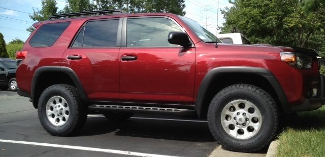

I have them(895E) on a 2012they lifted 2.5"
I quite like the ride.
Thanks for your reply. 2.5" is much higher than the others I searched in this forum. I will pull trigger and bet mine will be less than 2".

If so I think you will be the first. Even the SAW 1.5" nets out around 1.75-2" after settling. Others have also commented about the harsh ride with more than a few removing them. Then again, others love it so that is more subjective.

It’s likely that the OME 895E will give you more height and add a washboard ride. I realize that model year will come into play but they are promoted as just a 1.5” lift on older 4Runners 03-09 but on my stock 07 4Runner it was more like 3” height. When measuring the spring it has fewer spring turns and is about an inch shorter than the regular 895. I think I counted 5 wraps on the 895E vs 6 wraps on the 895 and a beefier appearance on the 895E. So just realize that if you are looking for a 1.5” lift with an older 4Runner the 895E is not the spring. The 895 spring is taller but settles more and should give you a 2” lift as per the more accurate descriptions.
