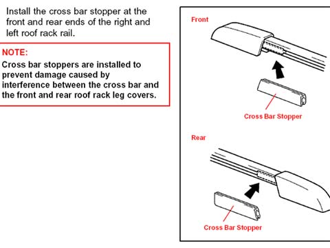

I just got a new 2007 4Runner SR5. Since the dealer did not install crossbars and just left them in the trunk, I installed crossbars myself.
The installation was fine. But I forgot to install those 4 rubber inserts? Are they important? Where should those rubber inserts be installed?
Anyway, if I need to put them in, I have to remove rail caps. I searched this forum and it seems removing rail caps is a little tricky. I am afraid I will break it. Any suggestions?
Congrats on the purchase, Hope this helps...there appears to be no need to remove the end caps...

Re: Re: Are rubber inserts for crossbars useful?
Thanks a lot for your illustration pics. They are very very helpful.
