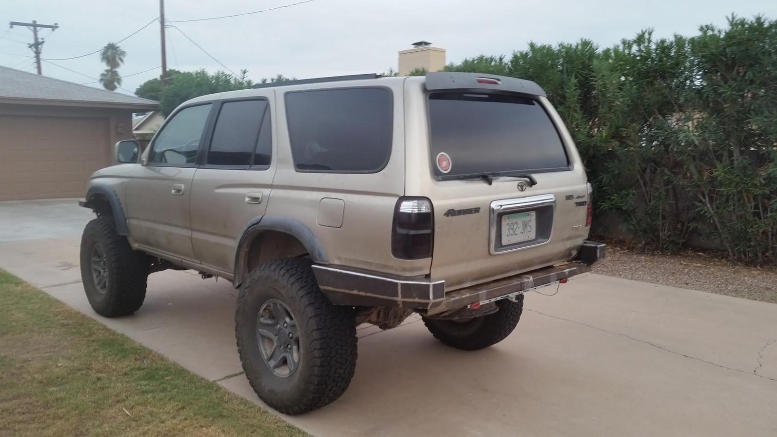

not a normal body lift though, the pucks taper in size from 0" in the back to 3" up front. It works nicely.
