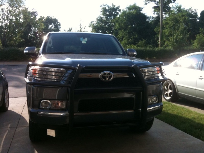

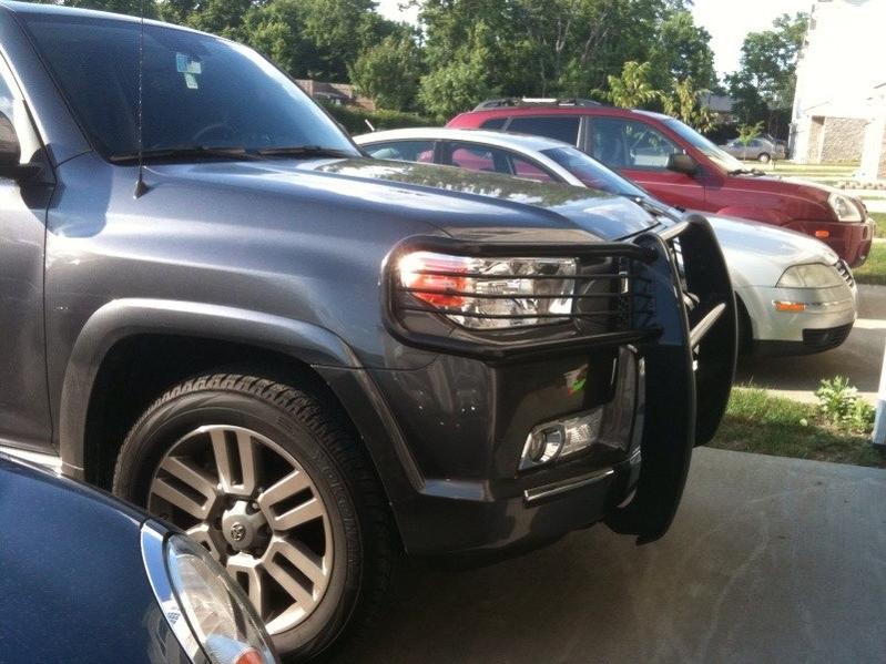

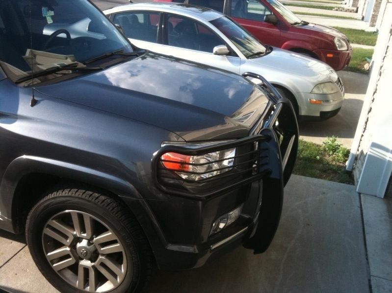

I have this grill guard. Tried to install it last January. However, the couldn't get the bolts off of the bumper bracket in like the 3rd step. haha It may have been a combination of the serious cold, and working in the limited space under my 4R because I didn't have access to a lift....
Regardless, took it to the dealership and had them put it on. Cost like $75 bucks for them to do it for me. Anyway, here are a couple pics of it installed. I apologize for the cruddy iPhone pics. If you want any other views just let me know.

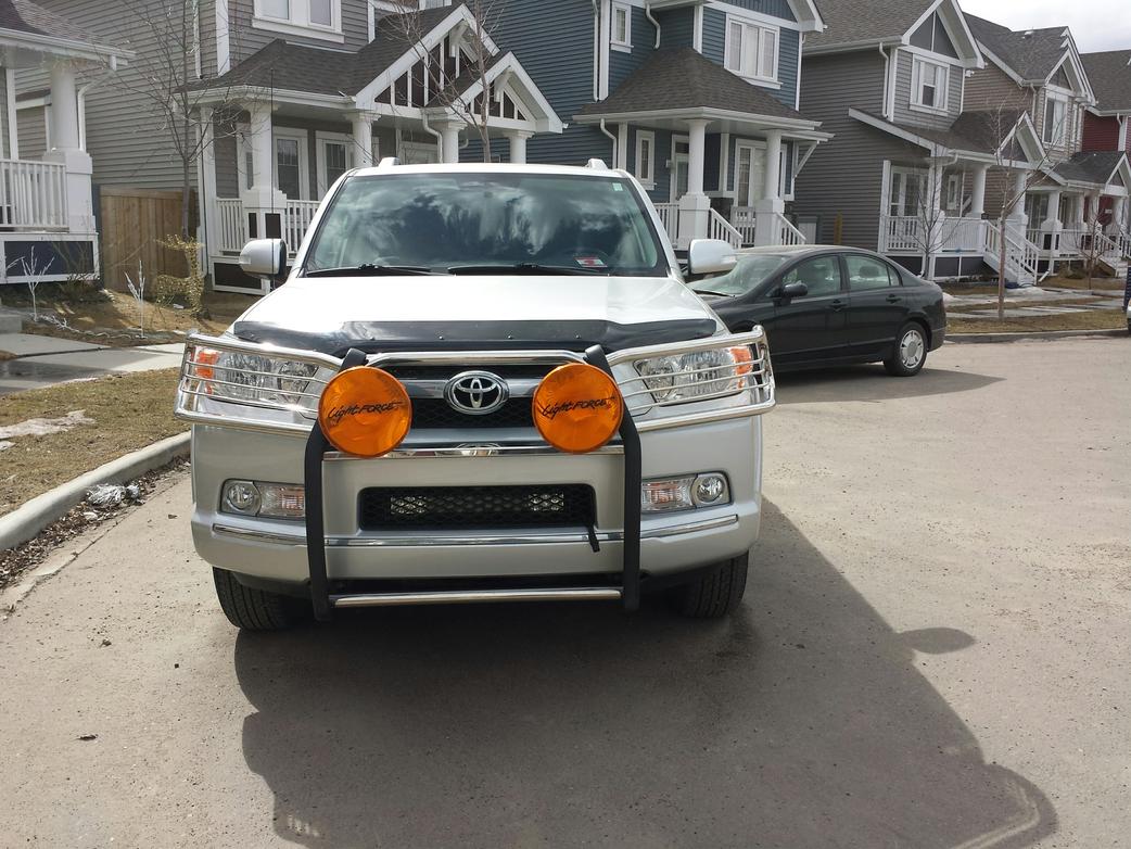

Same thing in Chrome, cost me 1500C$ (including taxes, import from USA and install) Cheers!
