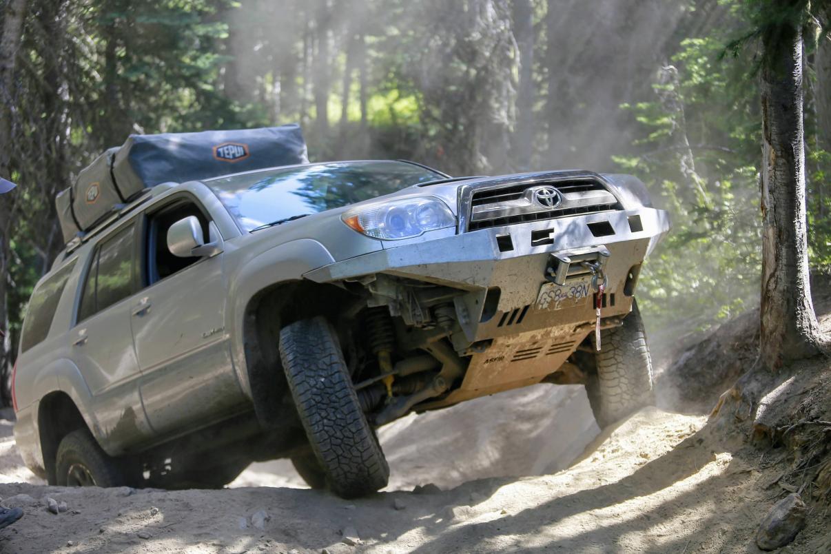

Reviving this thread b/c I bought their 4th Gen engine skid. Tried to install it today but the holes in the support bracket don’t quite line up. Has anyone else had fitment issues? TIA.
Aluminum skids can not take a hit. I had a set on my FJ and they will "fold" when you need them the most. Buy a seldge hammer cuz your gonna need it to straighten them out. I have a full RCI set on my T4R.
All the holes lined up for me when I installed it about a year ago.
I did have to enlarge 4 holes on the skid to fit their recessed washers, and I had to bend the skid as it wasn't bent enough. It was off by over 2 inches at the front mount. I relayed all this to Asfir with photos, they were very responsive. We agreed to them sending me a credit and I made the mods. Bending the skid took quite a bit of force using jacks and overbending to account for spring back.
Man that's crazy! I wonder if yours got damaged in shipping or something? For the bend I mean.
Mine seemed to be fine when I mounted it, I didn't have to do any bending or mod any of the holes. My only issue is, where the front part of the skid mounts to the two holes in the front crossmember, mine are so stripped they keep backing out. And the skid puts a bit of downward pressure on the threads because it could be bent ever so slightly more for it to fit perfect.
If I re-tapped those holes and moved to larger bolts it would be fine
